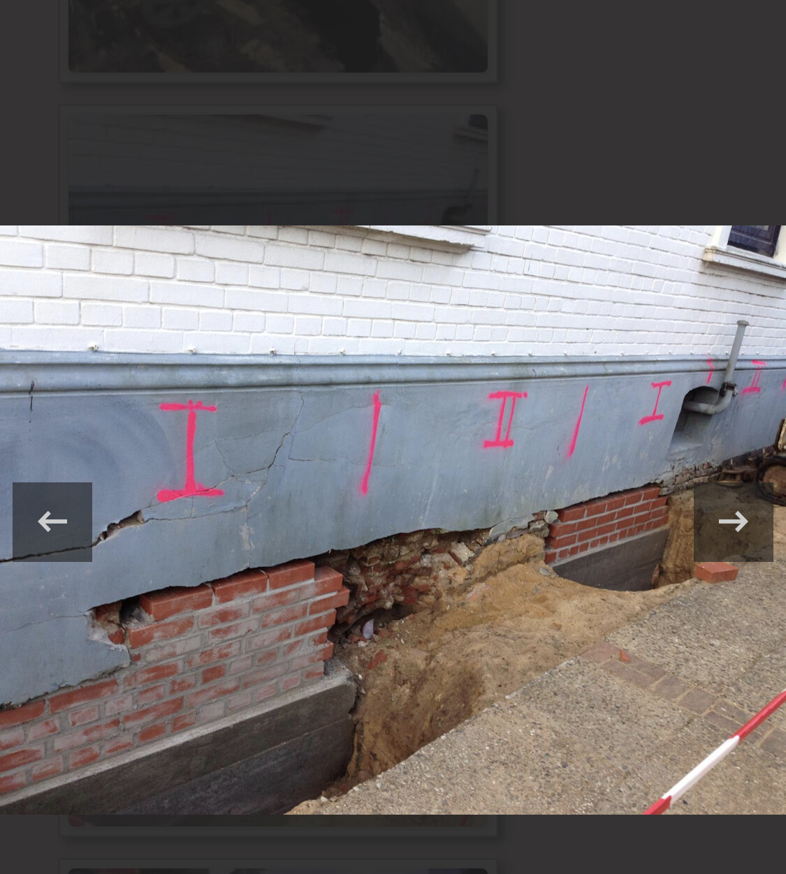

This is how it was done in our case after coordination between the foundation contractor and the structural engineer. Unfortunately, I don’t have photos where this is clearly visible. But if you search for “underpinning,” you will find examples. I quickly attached a photo from the internet showing the principle. As @haydee describes, the wall to be secured is divided into individual sections. You dig out the first and third sections, leaving the middle one standing. Then, the first and third sections are poured (or built up with masonry, depending on the situation) up to the existing wall. Once this has cured, work moves to the section that was left standing, which is then excavated, and so on.

The L-shaped concrete blocks are at least frost-protected, with foundations about 80 cm (31 inches) below the finished ground level. I suspect that the support of the L-block extends into the neighboring property. If you want to dig one meter (3 feet) deeper, the foundations of the retaining wall will also need to be lowered by one meter (3 feet). This can be done step by step, as mentioned before. Do you know why the excavator initially said to stop at this point and not go further? That will result in a significant additional cost. If you want to proceed this way, I strongly recommend handling it before the main construction begins, otherwise it will get even more expensive.

Get a copy of the neighbor’s retaining wall plans. Using L-shaped blocks may make underpinning more difficult in some cases.

Be sure to consult a structural engineer for the design of the underpinning beforehand. The attached image is very optimistic. Usually, the sections are only 1.25 m (4 feet) long. Try searching for BGBau foundations next to footings and underpinning.
