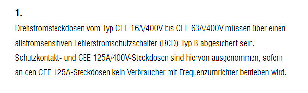

SaniererNRW1237 Oct 2022 14:07Oberhäslich schrieb:
The seller said, according to his electrician, that for private construction projects it doesn’t matter whether a Type B RCD is installed; this is only required in commercial construction. Unfortunately, I’m not an expert and feel even more uncertain. I’d rather not buy a panel that I can’t connect properly. Does anyone have advice? I don’t have an electrician lined up yet. As far as I know, the regulations apply to “construction sites.” There is no distinction between private or commercial work – a developer with multiple houses is also a commercial construction site, right? So it depends on what types of sockets need to be protected (see screenshot).
O
Oberhäslich7 Oct 2022 14:45They are the standard 2x 16A and 1x 32A outlets commonly found in a typical distribution board. Therefore, it is not permitted and, in fact, the electrician should not approve it, correct?
SaniererNRW1237 Oct 2022 14:50Here is the translation:
Oberhäslich schrieb:If a device with a frequency converter is connected, then no approval. If not, then it is acceptable. The simple Schuko sockets for the Hilti would be fine in that case.

Oberhäslich7 Oct 2022 14:55I read somewhere that construction cranes use these types of frequency converters. And since there is one for the bricks/beams, it is likely.
