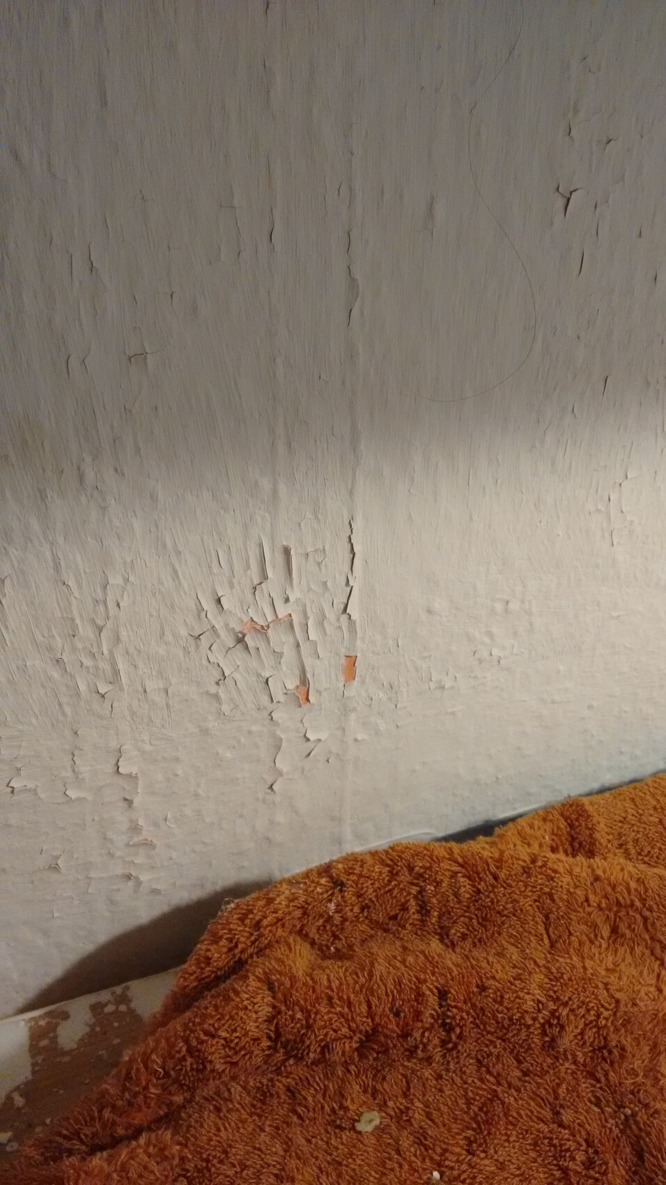

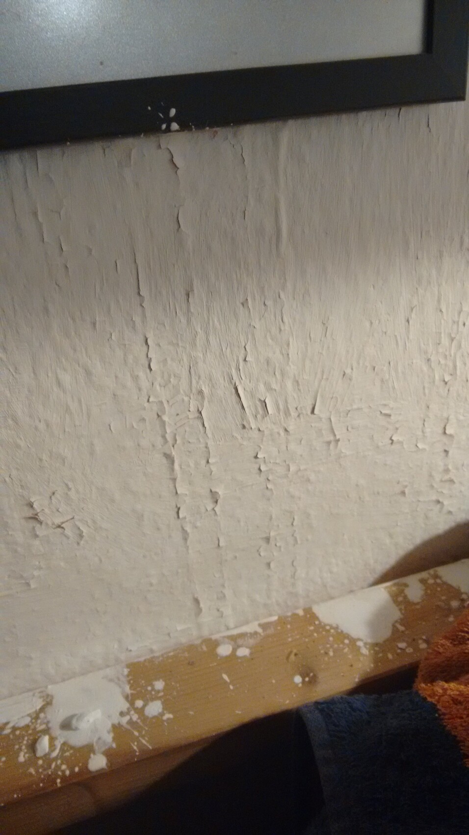

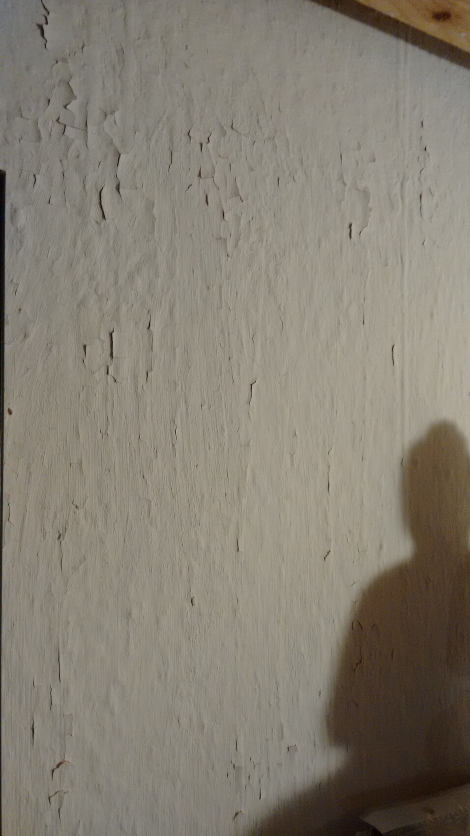

My wall looks like in the pictures. What steps are necessary to get it uniformly white without the paint peeling off?

30 Apr 2016 17:15
Wrong color on the wrong surface.
It’s possible30 Apr 2016 18:43
Wrong color on wrong substrate.
What steps are necessary to make it uniformly white without peeling?
30 Apr 2016 20:00
You need to remove the old material first. Then check the condition of the substrate. It might be worth removing everything and applying new plaster or wallpaper. If that’s not feasible because you don’t have the time or energy, scrape off some of the substrate and take it to a professional paint store (not a DIY store!). They can advise you on a suitable primer.
Neige30 Apr 2016 20:09
Well, I would go for removing them. 😉 Take down the wallpaper, reapply new wallpaper, and paint. It also looks like there is already quite a lot of paint on there.
30 Apr 2016 21:23
Neige schrieb:
I would go for it. 😉 Remove the wallpaper, re-wallpaper, and repaint. It also seems like there are already several layers of paint on it.
...it won’t absorb anything anymore anyway 😉
