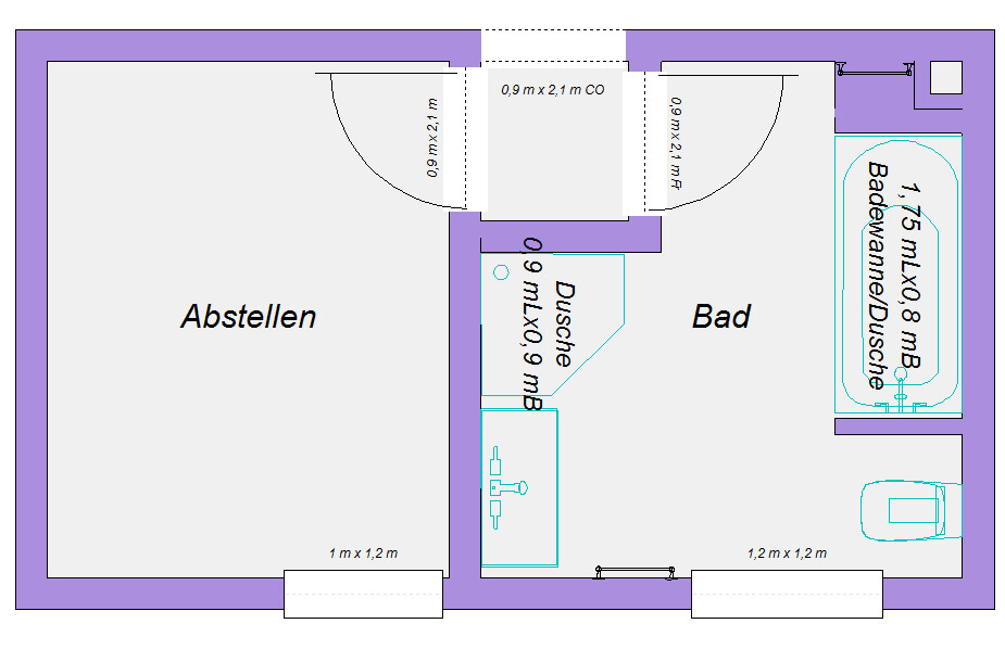

Since both bathrooms need renewing anyway (photos from inside will follow later), we are moving them to the front, facing the street. This will free up space downstairs to open up the kitchen/dining area and allow a slightly larger bathroom upstairs than currently exists. Right now, we live with a 3 m² (32 sq ft) bathroom—it works for three people but is definitely not very comfortable 😀

Thanks for the input, we will consider that! Over the past six years, we have managed well with the sit-down bathtub (110cm (43 inches)) in our small bathroom, but we have used it exclusively for bathing the children (sometimes even with three kids at once when friends were over). We definitely still need it for that purpose now, with two children. Personally, we’re not really bathtub fans. Before we moved in together, my wife also had a large bathtub, but she didn’t use it even once in three years.
