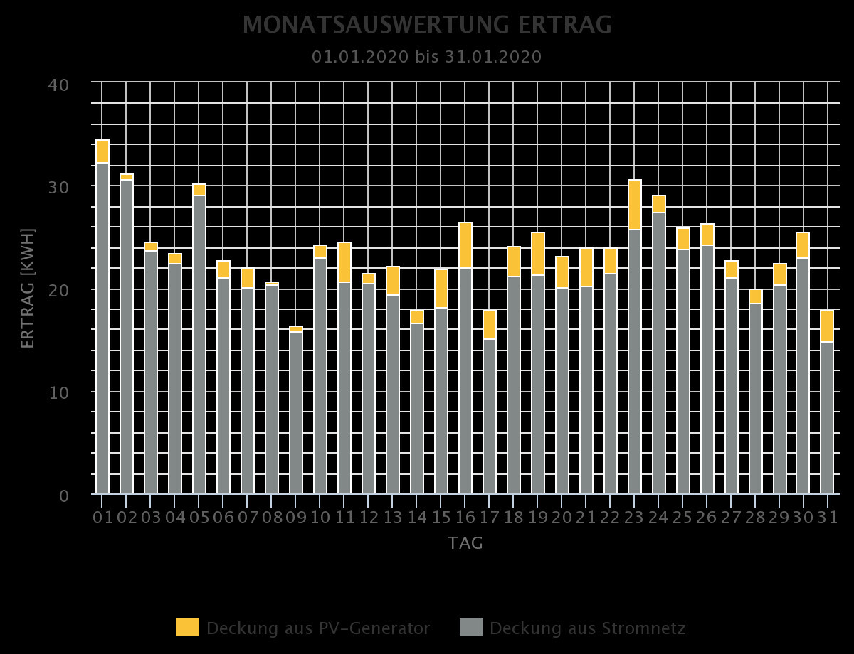

In our region of Middle Franconia, according to PVGIS, about 3% of the annual photovoltaic output is lost in January. This means you will hardly notice it regarding the heat pump, but that doesnât mean photovoltaic systems are a bad investment over 10-15 yearsâin fact, quite the opposite. However, one should forget the idea that the photovoltaic system noticeably supports the heat pump. st.From my own experience, I agree. Of the nearly 90 kWh (kiloWatt-hours) generated in January, we used 77% of that energy. Hot water accounts for nearly 30 kWh (kiloWatt-hours) per month. Heating uses 315 kWh (kiloWatt-hours). With a south and west roof combined system of 6.3 kWp (kiloWatt peak), itâs not a very large installation either.hegi___ schrieb:
I donât know your energy standard, but with a KfW55 plus photovoltaic system, you can easily manage with half that amount.Based on the Energy Saving Ordinance minimum standard. How much more have you spent on the air-to-water heat pump, rooftop photovoltaic system, and KfW55 compared to me? Our costs are 360 to 720 euros per year. Over 10 years, thatâs 3,600 euros; over 20 years, 7,200 euros...
