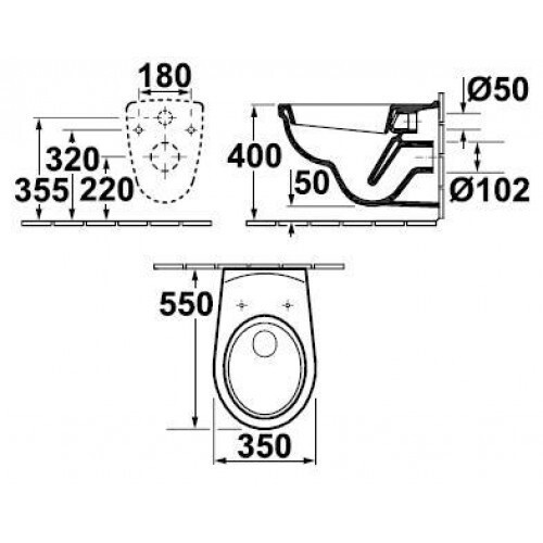

The concealed cistern element is from Geberit, and the toilet is from SAVAL (a brand of Villeroy & Boch). Unfortunately, small cracks have appeared after 20 years of use.
The options considered are traditional toilets without bidet or heating features, priced up to around 350 EUR.
Below are the dimensions of the current wall-hung toilet.
Will it be compatible with all models from Villeroy & Boch, Duravit, or Geberit?
nordanney10 Nov 2024 23:15alex2014 schrieb:
The options include standard toilets without a bidet function or heating, priced up to about 350 EUR (approx. $375).So about 1,000 models. In principle, any standard toilet should fit.Similar topics
