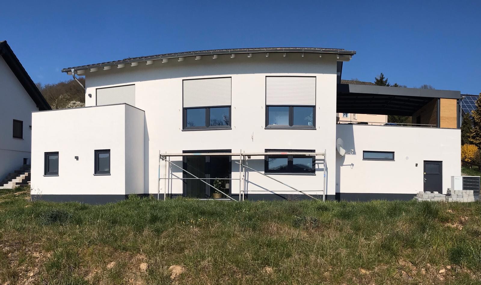

It doesn’t help. Exterior awnings are quite effective and fairly affordable. The best solution is Venetian blinds, but retrofitting them gets expensive.

chewbacca12322 Jul 2020 22:45
We have a house on a slope, with the living and dining areas upstairs. Now we are putting a terrace roof below. Take a look at the picture—should we install awnings above? Hmm.,

External venetian blinds
