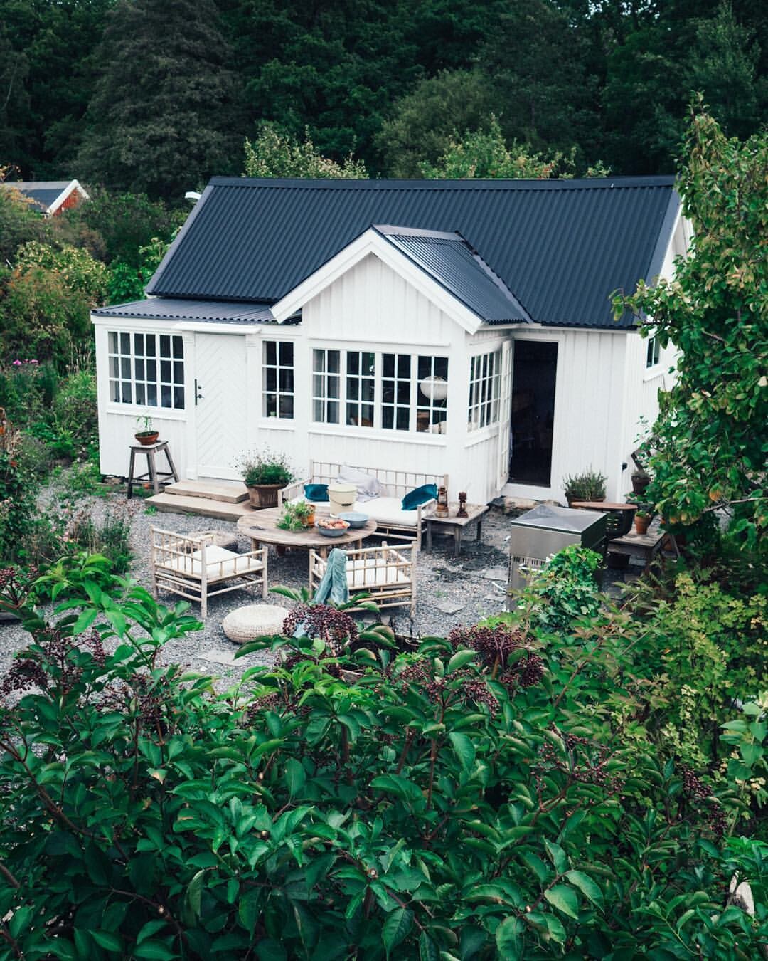

I am currently planning a small garden shed for our backyard.
It should look roughly like this:
I intended to build it using timber frame construction with a ventilated facade and likewise vertical cladding on the inside. Now I realized that the wall structure will be about 30cm (12 inches) thick.
Wall structure:
However, the proportions don’t really suit the small house (about 6 x 3 m (20 x 10 ft) interior). I feel the walls will then be much too thick.
Does anyone have an idea how to reduce the wall thickness but still keep the same appearance as shown in the photo?
Wall structure:

Barnhouse30 Nov 2018 18:02Yes, that would be quite a bit of movement.
Does anyone know how those old "Swedish-style houses" were constructed in terms of wall assembly?
Did they simply nail the cladding directly onto the studs without any ventilation, since there was no insulation?
