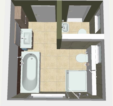

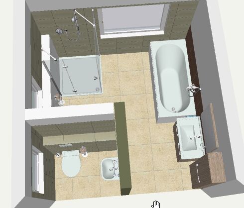

kbt, thank you very much for your effort! I have now also visualized it more clearly using a planner. If I choose a corner bathtub in your version, the exit from the shower to the bathtub or the toilet is very tight, so it would be best to exit diagonally.
Or do you think I should leave it as in the architect’s draft and just place the toilet between the shower and bathtub? I’m not sure if I want to move the windows again.
I can’t make a corner bathtub fit under the windows at all, can I?
I’m slowly getting frustrated, but when your thoughts revolve for days around the same topic and shifting sanitary fixtures back and forth, you eventually go a bit crazy – but you all know that, right^^

I made the guest toilet wider at the same time.
Unfortunately, I can’t follow your explanations at all. You definitely have to consider the window situation. I find a shower in front of a window impractical, and a window behind the bathtub isn’t ideal either, because you always have to step into the bathtub to clean the window or do other maintenance.
