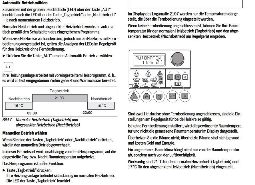

Mycraft17 Mar 2018 16:30
Did the defective control unit (thermostat) look like this?
White thermostat with rotary knob lying on paper with user manual
From the boiler’s user manual:
…If no remote control is connected, you can set your room temperature for normal heating mode (day mode) and reduced heating mode (night mode) directly on the control unit.
If two heating circuits without remote controls are connected, the settings on the control unit apply to both heating circuits…
As expected, adjustments on the heating device are indeed possible, even without a room temperature controller.
Image of a heating control unit with display and controls showing automatic operation

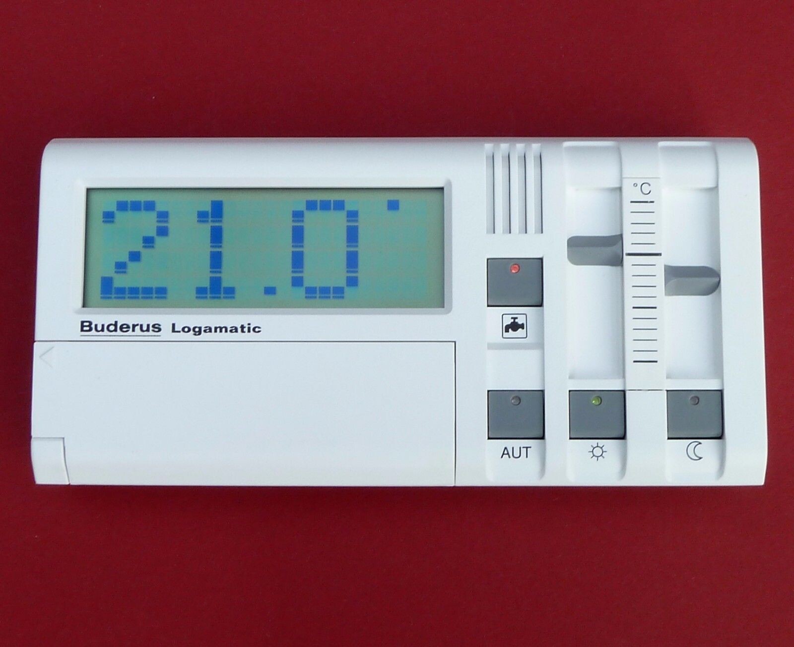

So you had this one here:
Digital heating controller Buderus Logamatic with display on red background
