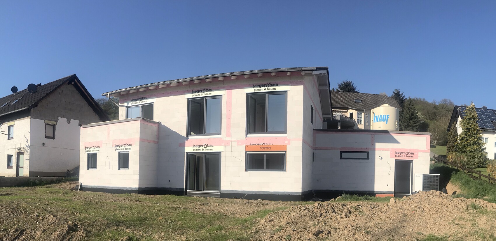

We moved into our new build four months ago. The living area on the ground floor has three large floor-to-ceiling windows facing south. We have underfloor heating and an air-to-water heat pump.
It provides a really comfortable temperature inside the house, but we have a problem – whenever the sun is shining in winter, even if it’s -2°C (28°F) outside, the temperature suddenly rises to 24°C (75°F) in the living room. It gets uncomfortably warm in here, and the underfloor heating can’t be turned down quickly.
Should we assume that the large floor-to-ceiling windows are responsible for the heat gain? A photo of the south-facing side of the house is attached.
What would you do – always lower all the blinds as soon as sunlight is forecast? That seems quite annoying...
We have motorized blinds controlled by Somfy. Would you consider buying a sensor that automatically lowers the blinds at a certain temperature?
Thanks in advance for your replies.

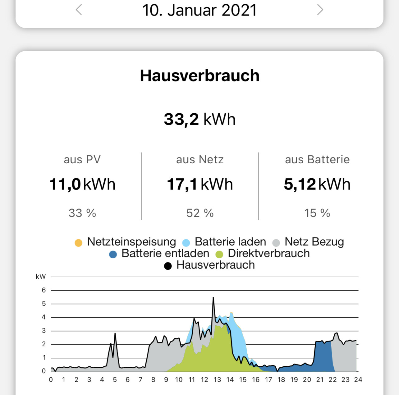

Daniel-Sp11 Jan 2021 13:46Mine is working very well….
...and I can't say yet, as I will only be able to check the two heating cycles after work.
But if the temperature difference is correct and nothing else is malfunctioning, then, as shown in the screenshot excluding the house consumption, the heat pump consumption yesterday was 18 kWh.
However, I still don't fully trust the whole setup.
