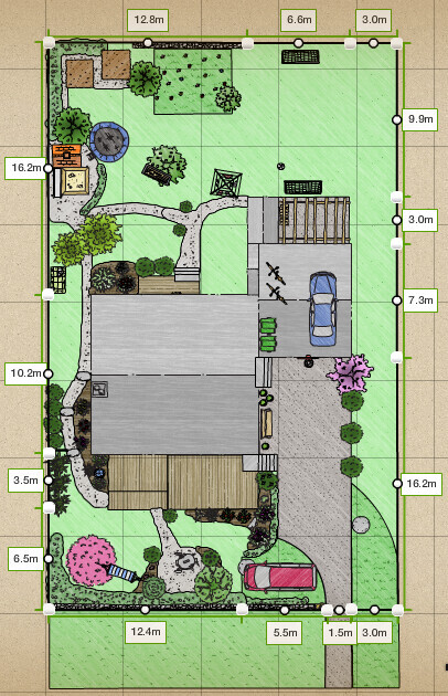

We are currently working on the interior finishing of our single-family home and plan to move in at the end of August/beginning of September. Naturally, we want to set up the garden as soon as possible so that at least the children can play, our privacy is ensured, and we don’t track dirt into the house. Of course, not everything can be done at once, but we can start with some tasks and “prepare” the garden for its future use.
What kind of work did you begin with?

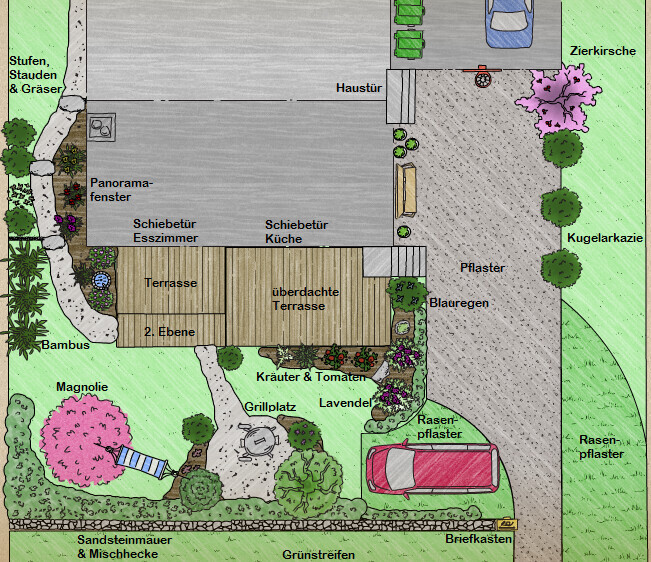

Attached is our current plan (with approximate dimensions) showing how the final result should look. South is at the bottom of the plan. The street runs along this side. On the west side, we have only 2.75 m (9 feet) to the neighbor (driveway); their garage is located at the property boundary where we have planned the children’s play area. On the east side, next to our garage, there is a 3 m (10 feet) wide path (see driveway) which belongs to us but may also be used by the rear neighbors for hedge trimming. For this reason, we cannot plant anything there. Beyond the path is another plot owned by the family which will not be built on for the time being. A north-facing terrace is also planned at some point but is currently the lowest priority.
Is there anything we could improve or any suggestions for the design? Have we placed everything in the right spot? What would you start with? What can be prepared ahead?
So far, we’ve only had a small townhouse garden that was already set up when we moved in, so this is really a big project for us.
Best regards, milkie

So everyone, one more question about the garden design. We are planning to move in around August/September.
When would you start the first work? Only after moving in? Or earlier? My question refers to specific points:
1. Driveway construction:
(leveling heights, shaping, paving, entrance steps)
This definitely needs to be done right away to 1. avoid bringing construction dirt into the finished house and 2. because the ground is currently not raised high enough to drive into the garage.
2. Raising the garden (~50cm (20 inches)) with the soil that is still heaped in 3 large piles. It needs to settle before it can be planted.
Priority is given to the south-facing garden (towards the street). At the property boundary, a small wall (height about 60–70cm (24–28 inches), stones available – DIY?) will be built as a height adjustment between the garden and the green strip.
The rest naturally has to wait for now. However, we would like to start relatively quickly with some parts of the garden and therefore the soil should probably be distributed soon, right?
When is it reasonable to carry out or have these tasks done?
