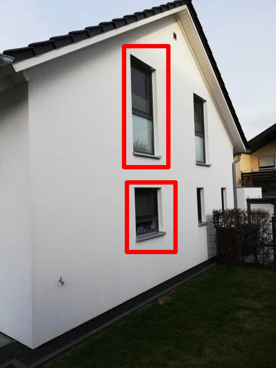

Last February, my wife noticed small brown spots on the exterior wall around a window frame. At first, we didn’t think much of it until I read online that it might be moisture. I then called our construction manager from back then and explained the situation. He came right away with a moisture meter and confirmed the damp areas. He also admitted that the problem was known and that during a certain production period, leaks could occur. They still don’t know exactly where the moisture is coming from, but it has something to do with the connection between the window, the window sill (aluminum), and the roller shutter box. However, this problem has since been resolved in the design, and now only stone window sills are installed. He also advised us to write to the managing director and threaten to make the issue public. The construction manager has since quit! That says a lot already. But action speaks louder than words. We sent a relatively polite email and promptly received a reply. I was informed that we would receive a written offer, and if I were to take the issue public, they would initiate legal action and refuse to carry out any repairs on the house.
Then came the shock in the mail. The repair would cost €20,000. The entire side of the house would be redone—5 new window sills, removal of all windows... They also pointed out that the repair would be visible since there would logically be aluminum sills on three sides of the house and stone sills on one side. The side will be replastered and repainted, which will also be noticeable. Additionally, any damage to the garden will not be covered.
So my question is: What would you do? We do not have legal protection insurance. The construction manager said a lawyer would have no chance because this was the standard technology at the time. Others have already tried before us.
I have even considered sealing every joint and corner with silicone.

HilfeHilfe17 Jan 2019 07:02Hello ECU, do these brown pixels and the slight brownish area below bother you? Or is water getting into the house?
I would never, ever spend 20k on that...

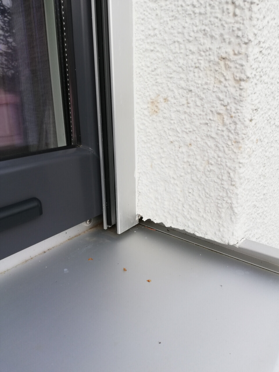

Quick update.
I spoke with a local window specialist. He wants me to send photos first, then he will decide if he can repair the window or if he needs to come by and take a closer look. Apparently, every prefabricated home manufacturer uses a slightly different system for sealing windows.
Attached is a photo of the leak at the kitchen window. The other side looks similar. Oh man... the house looks like it's about to collapse. And you want to open up the facade for that? Better put that money towards an early mortgage payment instead.
yvimarkus17 Jan 2019 07:20These spots are not very prominent at the moment. However, they change depending on the intensity and duration of rainfall. When it rains for a long time, the spots can be as large as a one-euro coin and appear on the exterior wall as well (not just on the inside next to the window). Strangely, the spots also disappear very quickly.
I measured the area myself with a moisture meter (though it’s a cheap one with two probes at the front). It showed significantly higher readings there compared to the rest of the house.
Where I took the measurements, I had to press into the plaster. Now there are especially many spots in that area. Hopefully, I didn’t cause any damage.

yvimarkus17 Jan 2019 07:21Oh, I see... No water is entering the house. However, the primary concern is the installed timber studs. These are not supposed to be damaged.
yvimarkus17 Jan 2019 07:24Ok. I’d say no one would remove a window for that!
My advice is that this is a job for a painter, plasterer, or the plaster manufacturer. Are the stains only in the window reveals? Maybe something is oxidizing with the plaster there, causing it to lose its water-repellent properties in those spots and therefore become damp?
