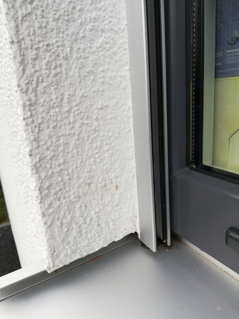

I spoke with a local window specialist. He asked me to send pictures first, and then he will decide if he can do anything about the window or if he needs to come by and take a closer look. Apparently, every prefab home manufacturer has a slightly different system for sealing windows.
Attached is a picture of the leak area on the kitchen window. It looks similar on the opposite side.

Are you basing your question solely on these small spots and the site manager’s measurement? I’m also missing an overview photo to see the location of the spot on the building.
At the risk of making a fool of myself: I don’t see anything here that would concern me. After 8 years, the plaster won’t look brand new anymore.
