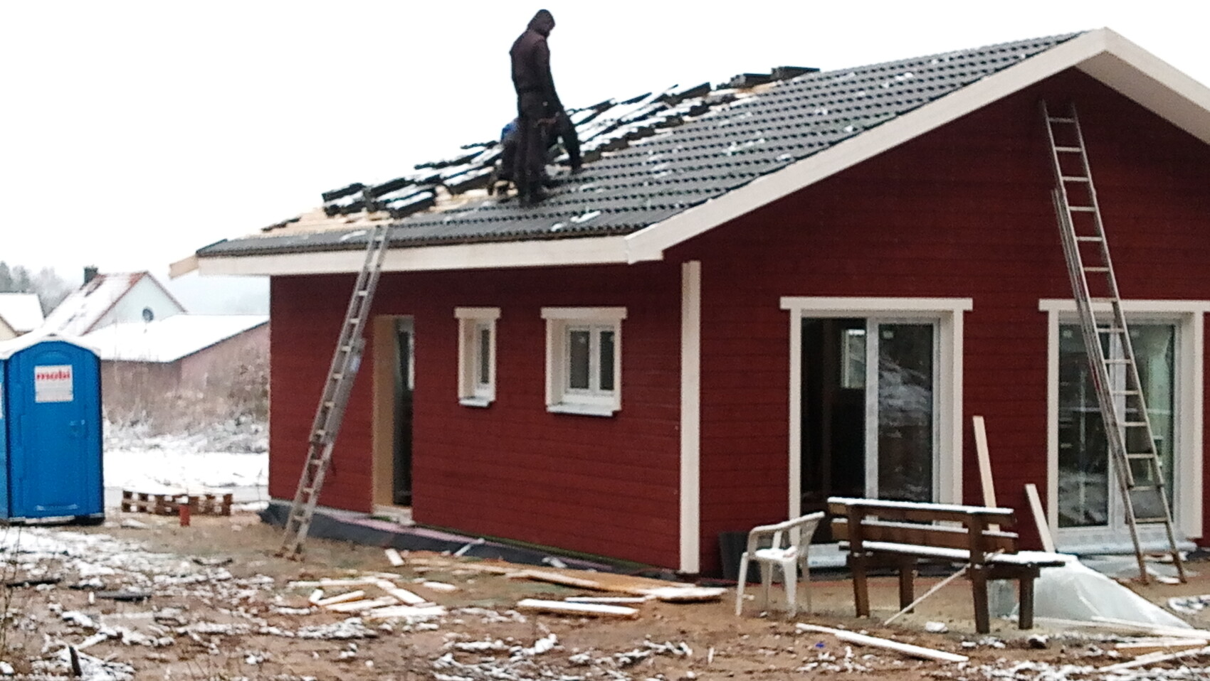

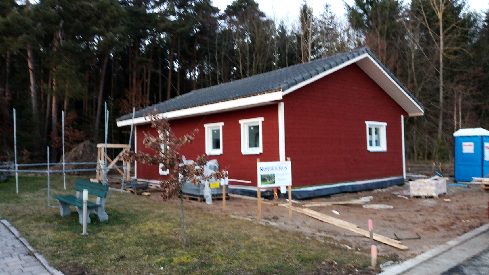

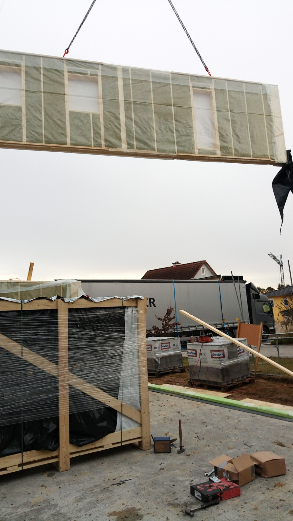

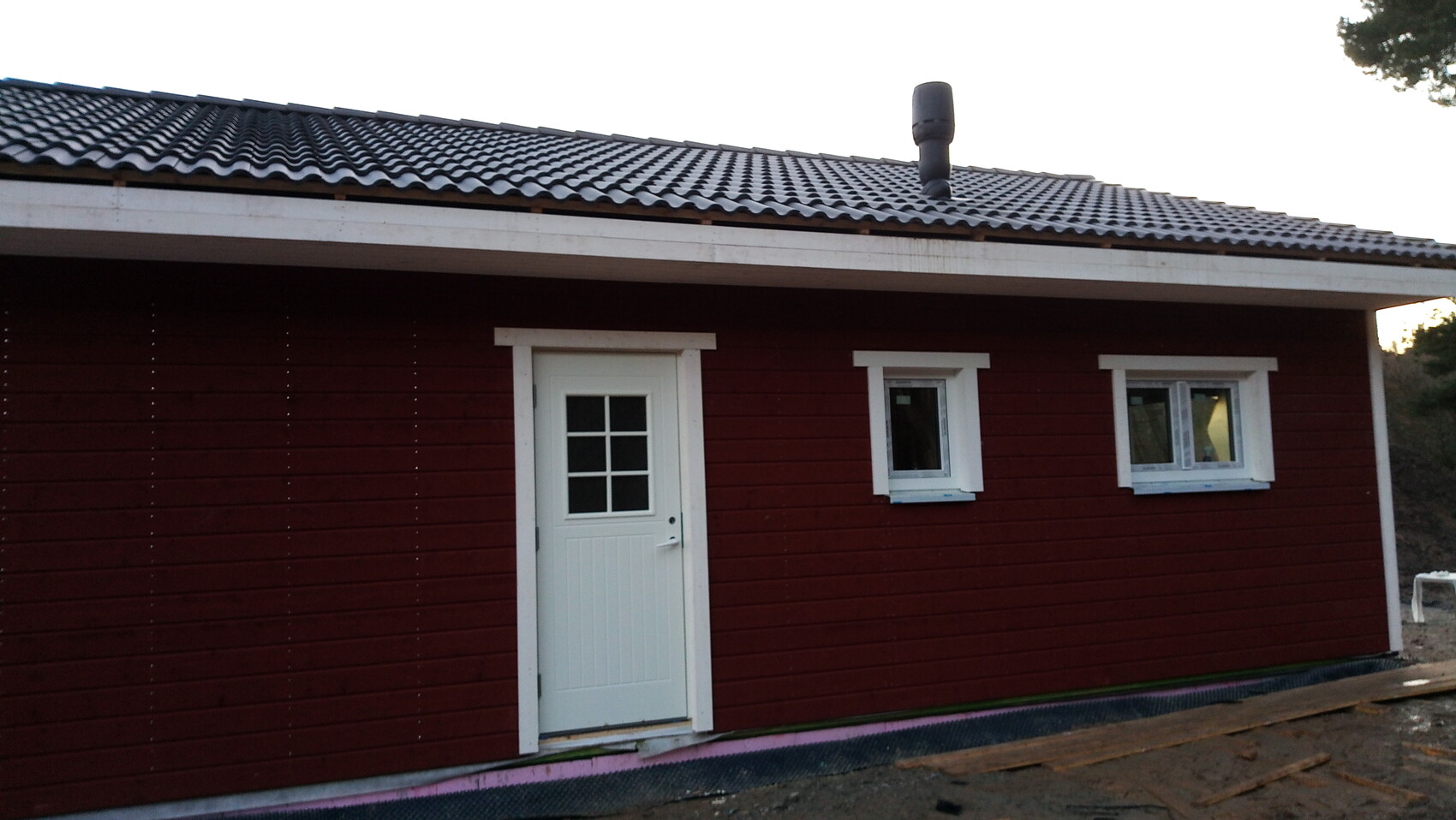

Gerd Karin14 Feb 2020 06:19In January 2020, our house, a Norges Hus model 59 from Estonia, was installed in Burk. We purchased it in Germany through the respective local provider. The building permit / planning permission took two days and was then granted. The foundation turned out very level. There were no problems during installation. Our house was delivered with the front door and a finished roof with tiles, so the exterior was almost complete. Now the interior work begins. The interior studs were also installed. We can now freely decide who will do the interior construction. There are many options to negotiate prices. Everything is made of wood; a cordless screwdriver is sufficient to complete the rest, along with whatever tools you might need. We will install an infrared underfloor heating system. We will also install a cold water pipe. Hot water will be supplied via an instantaneous water heater. We will apply for electricity for heating. The house cost us a total of 50,000 euros (approximately $54,000), excluding the foundation and building plot. We made a deposit of 20,000 euros (about $21,600). The remaining payment was made upon delivery, as soon as the truck was parked in front of the house. Nothing ventured, nothing gained.
