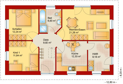

Try searching on Google for some typical floor plans of 90 sqm (970 sq ft) houses. Compared to an apartment, you have to accommodate all the technical installations yourself, and you usually don’t have a basement space, which is often separately available with an apartment. This is just to help you understand what can be achieved in a 90 sqm (970 sq ft) house.

Bauanfänger3612 Feb 2017 15:49Thanks to everyone for the critical and constructive feedback, as well as the house proposal from Danwood and the floor plan from Nordlys. I am aware that my goal might not be entirely achievable, especially considering the earlier assessments from this forum.
