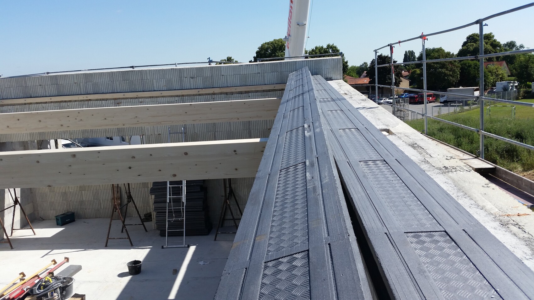

2. I don’t use everything from Euromac2. I have used the blocks and the roof elements. The roof elements are excellent and very quick to install.

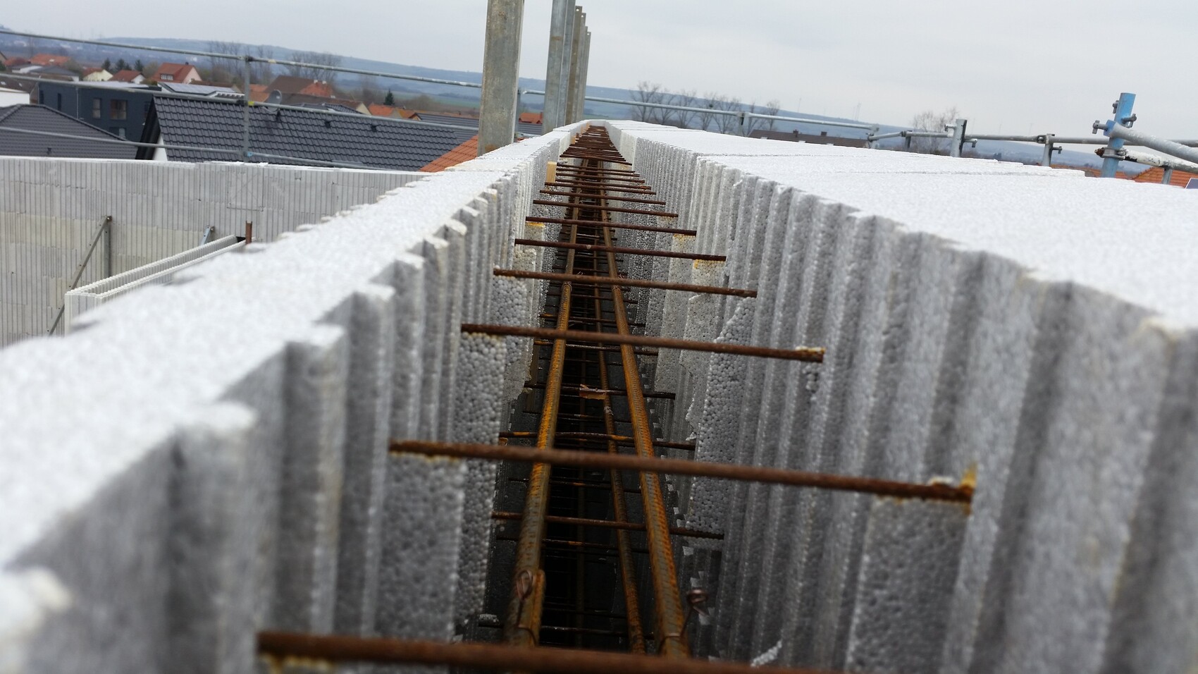

Attached are two photos from the construction back then.
