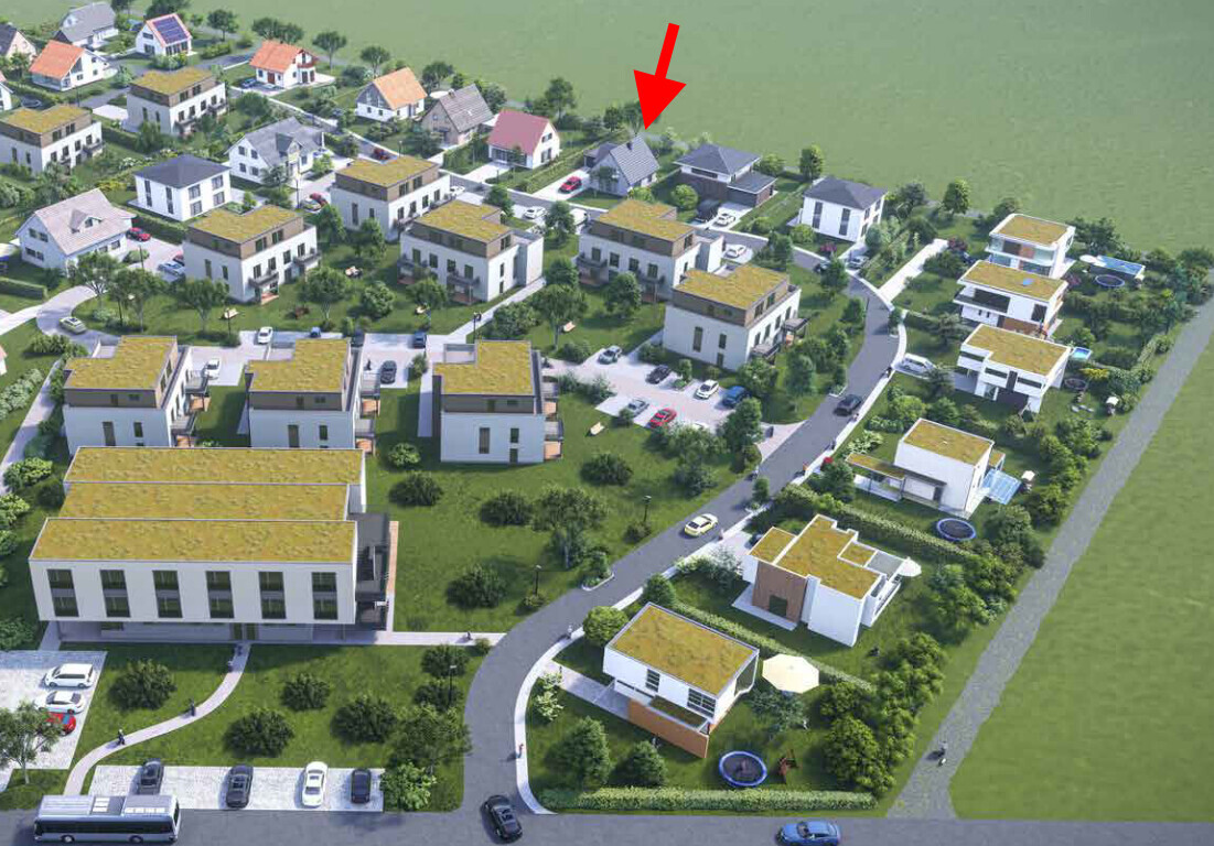

I marked your plot in an image from a presentation found online—to illustrate how the developers of the residential area envision its construction:
Hausbau20mr schrieb:
We plan to build a basement-equipped semi-detached house with 3 residential units (one standard semi-detached unit with about 140-150sqm (1507-1615 sq ft) and one semi-detached unit with two apartments totaling about 230sqm (2476 sq ft)). There, that works. At least it’s a start.
I marked your plot on an image from a presentation I found online. Close but still off.
But whatever. The visualization nicely shows how much freedom the development plan allows. Only the floor area ratio is too low for the original poster’s project, although they haven’t explained how they arrived at the specific desired living area figures.
Maximum floor area 773m² (8320 sq ft) * 0.5 = 386.5m² (4161 sq ft), which roughly corresponds to 80% * 386.5m² = 309.2m² (3328 sq ft) of living space. Maybe you can squeeze a few more square meters out by including non-habitable rooms in partial floors and wall thicknesses, but in my opinion, 330m² (3552 sq ft) is probably the absolute limit.
