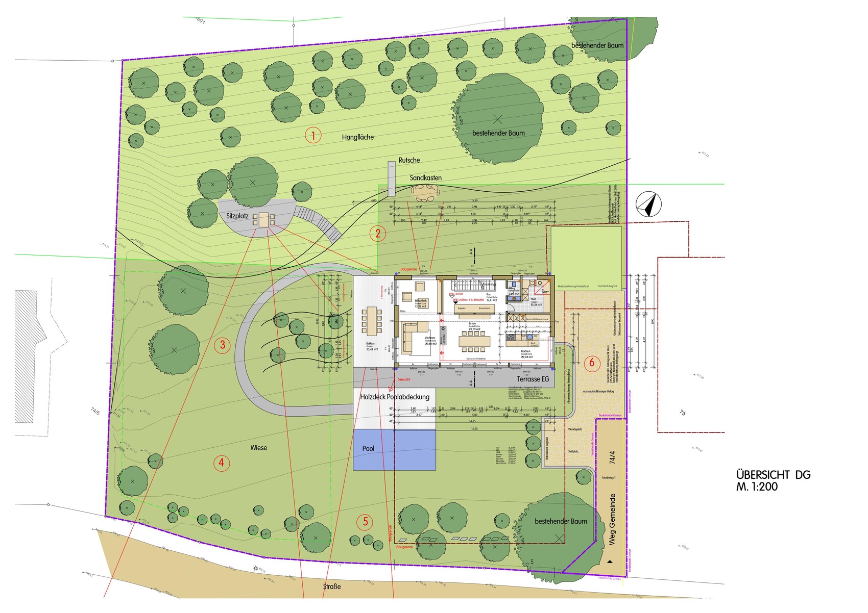

Thank you for the detailed responses. The pool should be approximately 8.00m x 4.00m (26 ft 3 in x 13 ft 1 in), as Rick mentioned, fully in-ground and surrounded by patio slabs. A pool heater and a counter-current system would be great, although they are likely to be quite expensive.
Attached is an early sketch of our garden design. The movable wooden deck was just an idea at the time, but we have already dismissed it.
@Solveigh thanks for sharing your plan.
It seems like a great plot.
A movable deck is nice but quite expensive. You probably decided against it for this reason.
For an 8-meter (26-foot) pool, a counter-current system is essential if you want to swim properly.
Pool depth nowadays is usually set to a maximum of 1.40 meters (4.6 feet). Greater depth doesn’t add much benefit for swimming but increases the effort (larger filters, pumps, heating costs, etc.) due to the higher water volume.
Since you’re far enough from the house, installing the pool afterwards is quite feasible. Besides the construction space, you need about 1 meter (3.3 feet) of installation space around the pool (which will later be backfilled and covered). Have you already considered what type of pool you want or how surface water will be drained? With standard skimmers, there would be a significant height difference between the terrace slabs and the water surface. Flat skimmers are more expensive but reduce this difference somewhat. Alternatively, you could install a channel around the pool. Plastic doesn’t look very good, stainless steel is expensive... but then you’d be almost level with the slabs. An overflow pool isn’t suitable in your case and would be even more expensive.
Under your deck would be a good spot for the pool equipment. I would definitely have this space included during the house construction. The pool waterline should be below the ceiling of the equipment room; otherwise, the compensation tank won’t work properly.
You’ll need:
- Electricity (230V and 400V) for pumps, filters, dosing systems, pool cover, underwater lights…
- Water supply
- Wastewater connection
- Optional LAN
- Optional heating connection
On or at the deck, provide power outlets and a water connection for the pool robot and for cleaning the pool robot or pressure washer…
You should already start thinking about the heating system. If you have a gas heater, the easiest solution is to install an additional line and buy a significantly larger boiler. A large heat exchanger can be connected to this line later.
Alternatively, you could install a heat pump in the garden later and hide it. It will need to be winterized though… Or the classic option with solar collectors. In my opinion, this looks unattractive if you can’t hide them on a roof.

Thank you, Rick, for the detailed response. The plot is actually not bad, but it does have a 16m (52.5 ft) height difference. That’s why we started planning the garden early. Although, at this early stage (ahem, 2.5 years of planning time), you never really know if there will be any money left for a pool by the end of construction. So, I prefer not to bother specialist companies with detailed questions yet, since I don’t know if I will be able to hire them. How is this usually handled during construction, when you’re unsure whether you can actually commission certain services?
