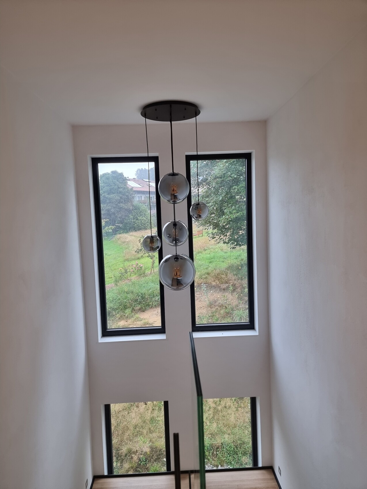

Top lighting is also grazing light. It must either be completely diffuse or come from the front.
A difference of more than one centimeter would already be significant. There is probably a standard for that, but unfortunately, I don’t know which one.
The light in our case comes from the front, since that’s where the windows are located, right? The entire stairwell is therefore illuminated by it.
For us, the light does come from the front in the stairwell.
The windows illuminate the entire staircase. And when I switch on the lamp, it actually looks even worse.
