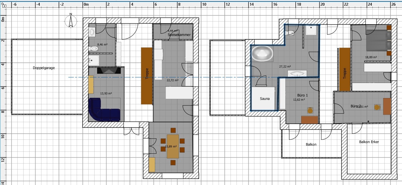

Elias_dee21 Jan 2022 08:44Good morning. Here is our first draft of the ground floor (GF) and upper floor (UF) plans (we have not yet discussed this with the architect). We are thinking of building a solid double garage with living space above it on the upper floor. There will also be a balcony above the bay window on the ground floor, which extends further to serve as a covered terrace (unfortunately, this is not very clear in the drawing).
We still need to design the basement, which will follow the dimensions of the ground floor.
I believe the rooms are all clear: on the ground floor there is the living room, kitchen, pantry, dining room, and bathroom. On the upper floor there are two offices, a bedroom with a walk-in closet, and a wellness bathroom. The basement will include a guest room, fitness area, utility room, and technical room.
Feedback is welcome!
