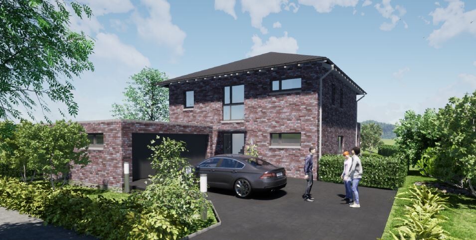

Single-family house without a basement, double garage, 170 m² (1830 sq ft) of living space, KfW 55 energy standard, 2 full floors, hipped roof on about 1000 m² (0.25 acres) of land, garden facing north, main road traffic in a village of about 1,000 inhabitants near the Lower Rhine region. To the north there are only fields, horse farm on the right, single-family house on the left.
GC planning – The GC gave us the names of all the companies we needed to contact. All companies were familiar with the project and knew what had to be offered. We were able to make requests and adjust selections as needed. Meanwhile, structural engineering and energy consulting were done in parallel.
Shell construction – strip foundations and reinforced concrete slab, 80 mm (3 inches) of perimeter insulation beneath the ground floor slab, 15 cm (6 inches) of calcium silicate masonry, clinker brick (Muhr – Friesland, with anthracite-colored mortar joints), clay roof tiles.

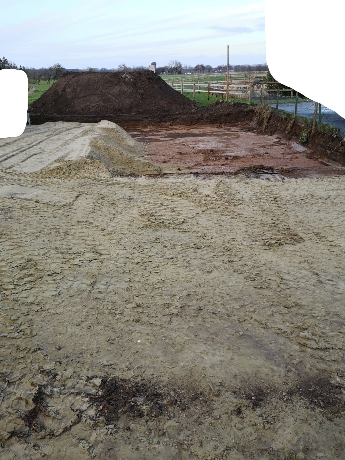

We commissioned our own soil survey, which determined that about 1 m (3 ft) of soil needed to be replaced. The GC informed us immediately and adjusted their calculations accordingly. So far, costs have been completely manageable and predictable.
The building permit was granted at the end of November, after just over 2 months of processing. In December, financing was finalized with a regional bank (see my financing thread for details), and the GC contract was signed.
We spent the holidays relaxing, and this week earthworks have already begun. Next week the crane will arrive, and foundation work will start. The weather looks good. We’re very excited to see how things develop. The construction period is set for 10 months. If everything goes well, we can spend next Christmas in our new home. 🙂

I’ve attached a photo of the earthworks and a spoiler of the future house (clinker bricks not as planned, roof rafters gray).
