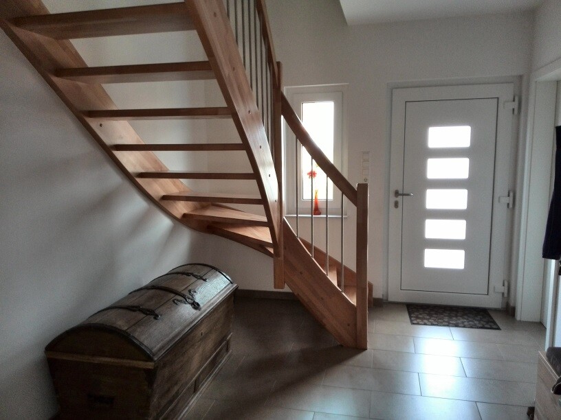

I don’t quite understand the entrance area being too dark? We have windows by the staircase, so there should be enough light coming in, right?We also have a window by the stairs, similar to yours. But your hallway is almost 6 meters (20 feet) long, while ours is only 3.80 meters (12.5 feet). We also get light through the glass door opposite and the front door with glass inserts. However, we have an open wooden staircase.
As you can see, most of the light comes through the door (the sun is shining here at the moment, the entrance faces east). If you have a closed staircase, it will be darker. Also, your hallway is longer and the light simply doesn’t reach as far into the space.
