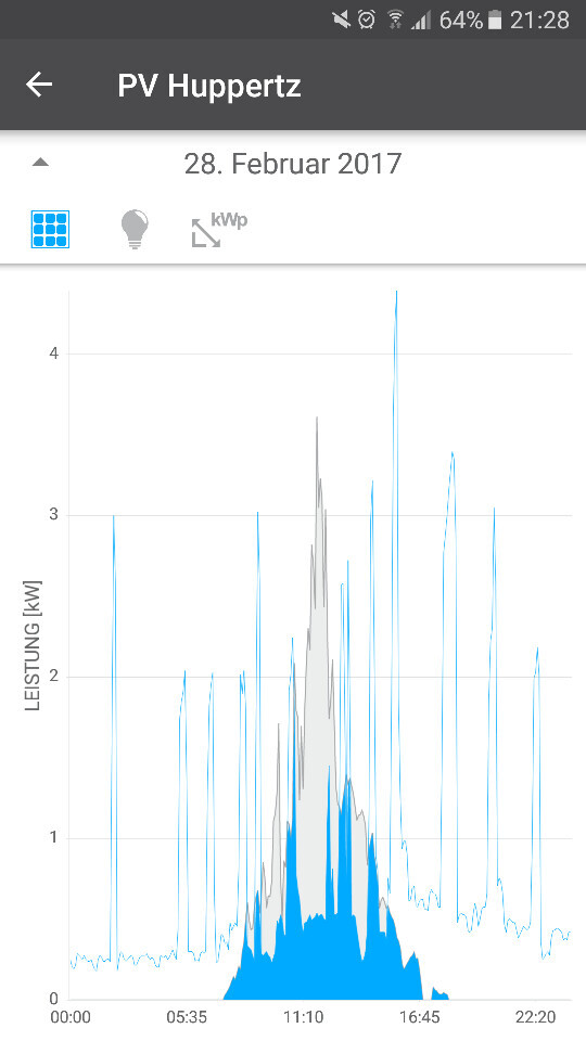

toxicmolotof4 Mar 2017 12:49@Alex85
Even though many sellers claim that east-west orientation is the latest trend, it doesn’t make any mathematical sense for a flat roof on a single-family house with a system size below 10 kWp, unless you want or need to use every square centimeter.
@toxicmolotow
Okay, so you decided against it consciously? On a flat roof, you usually have the option.
The idea is to compensate for the lower yield from east/west orientation by increasing self-consumption. But, of course, this always relies on assumptions that it will actually be worthwhile.
