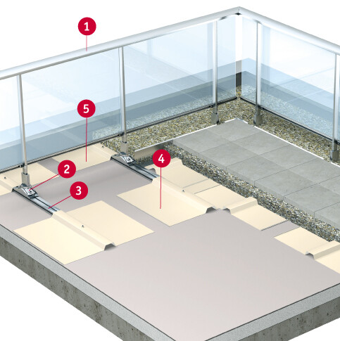

who has experience or knowledge about the "construction" or use of a flat roof? Specifically, it concerns using a flat roof for occasional access, such as a rooftop garden, etc. The main point is this: one part of the roof (not on the outer edges!) should be secured with a railing.
There is the possibility of using industrial-type inspection railings which are free-standing due to their own weight and additional load (gravel, slabs). Would this be feasible on a private house? Has anyone done this before? Has anyone installed something similar without penetrating the roof membrane?

"....... does anyone have experience with this and/or has built or installed something similar (free-standing fall protection barriers!)
The situation is roughly like in the photo, but for a flat roof new build..."

Thank you,... so it looks like there are at least two of us. I have to smile here because apparently no one is really reading carefully or making the effort to do so... and I hope you know what the term "cantilevered/self-supporting fall protection" actually means... and for the second time: no, not a concrete slab (otherwise it could be fixed, which I don’t want due to penetrations... see text), and yes... I know everything is stated there... no penetrations... yes, that’s why I asked the question again earlier, or actually right from the beginning... no sketch needed for that! I want to know if anyone has possibly installed something like this, is satisfied with it, or can recommend a manufacturer..., like the example attached.

2) Access to the flat roof can be possible via various routes. Preferred is an internal access/staircase combined with a roof hatch with a glass dome and electric open/close function. Has anyone ever installed something like this or solved it differently? Any experience on this topic is appreciated, thank you! This is also quite common in industrial construction. A skylight dome (usually made of GRP) with an electric motor and a ladder placed from below when someone needs to access the roof for maintenance. The advantage is that you don’t have an unsightly fixed climbing ladder on the interior wall. An alternative would be a fixed climbing ladder on the exterior wall, but that is not very attractive visually either.
I always get uneasy when a railing does not have a proper connection to the substrate. Of course, it works with large base plates (= own weight) and gravel on top. You can have this made by any metalworker or, like the manufacturer in your photo (Fa. Hei...), produce it accordingly. However, I have no personal experience with such railings.
How often does someone actually need to access the roof for maintenance? There is also the option of fitting anchor points on the curb of the skylight dome, where a safety rope can be attached during maintenance. Then the issue of a railing is completely avoided.
