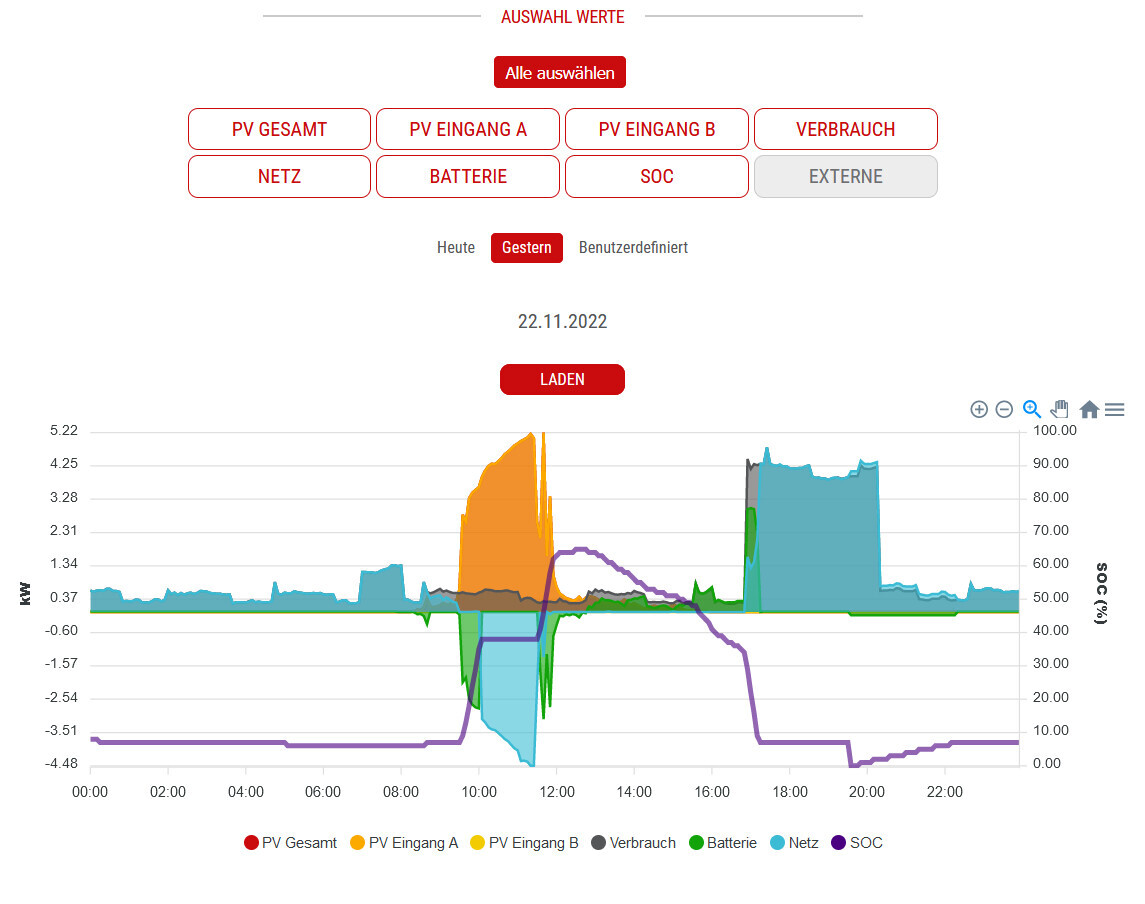

Today it was just under 16 kWh, but it was relatively sunny.
In addition, I also charge my car with self-generated electricity whenever possible.
So in winter, I have nothing left over. Yesterday it was only 11 kWh, and the day before even just 1.95 kWh 🙄
The graph is from yesterday (I charged about 10 kWh into the car last evening/night)

RotorMotor23 Nov 2022 16:00i_b_n_a_n schrieb:
So in winter, I have absolutely nothing left over. Yesterday it was only 1 kWh and the day before even just 1.95 kWh 🙄Yeah, well, what do you expect to do with a bigger storage system then!? ;-)i_b_n_a_n schrieb:
That is often the case with a small system. I have a brine-to-water heat pump.
Today it was just under 16 kWh, but it was also relatively sunny.
Additionally, I try to charge my car with self-generated electricity whenever possible.
In winter, I basically have no surplus at all. Yesterday it was only 11 kWh, and the day before just 1.95 kWh 🙄
