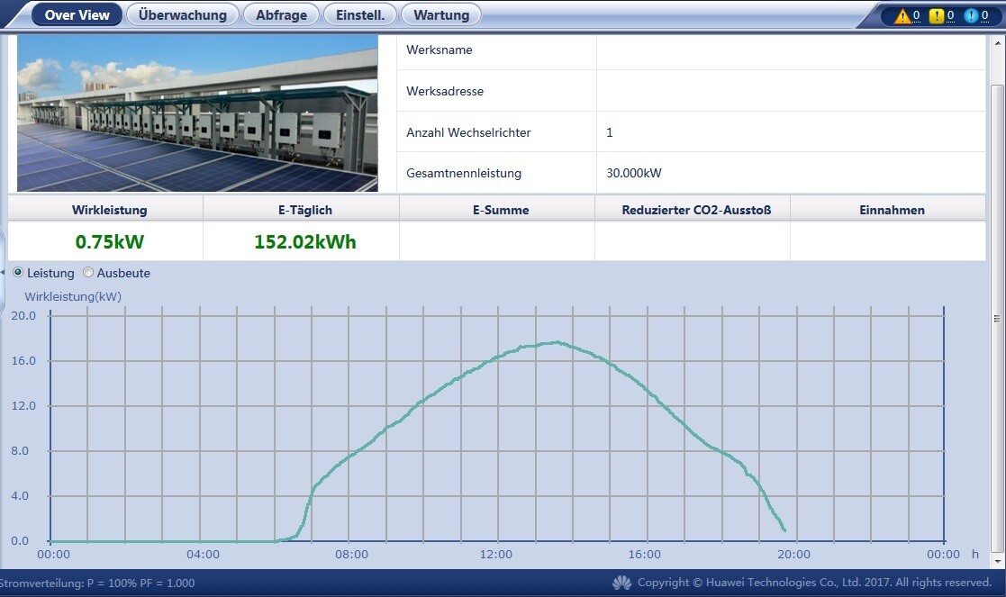

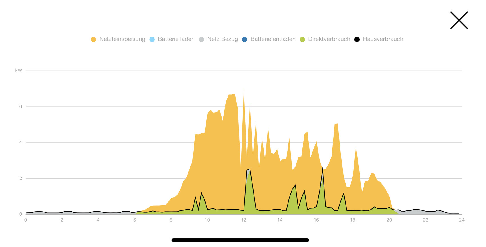

Stefan890 schrieb:
Could you please check how much that adds up to over a whole day?
Yes, on my portal/app the display is often delayed by 12 hours. However, a completely new portal is supposed to be launched in June/July. I’m curious and hoping for improvements.I can show you tomorrow afternoon, then I will upload the full screenshot from today.You should set the battery charging so that it only starts around 11 o’clock or so.
If your inverter is softly limited, that means it allows more than the 70% limit, but you only feed in 70%. So, let’s say your system produces 90% around midday. Then you lose 20% (90 - 70). However, if you charge your battery during that time, you can use those otherwise lost 20% to charge your battery. And until then, you don’t need it fully charged anyway.

Everyone has to decide for themselves if the effort is worth it. In the end, the amount you save isn’t huge. I’d probably do it anyway because I’m a bit of an environmentalist who would also build a KFW40 house ^^ Thanks, I understand now! Makes sense. Since I have the inverter, I can’t really control the timing. Just checked. But maybe it’s just the mobile version of the portal again.
Google says the SMS inverter has 5 charging windows. Kostal has none; it starts charging as soon as the photovoltaic system is producing. There’s no other option.
