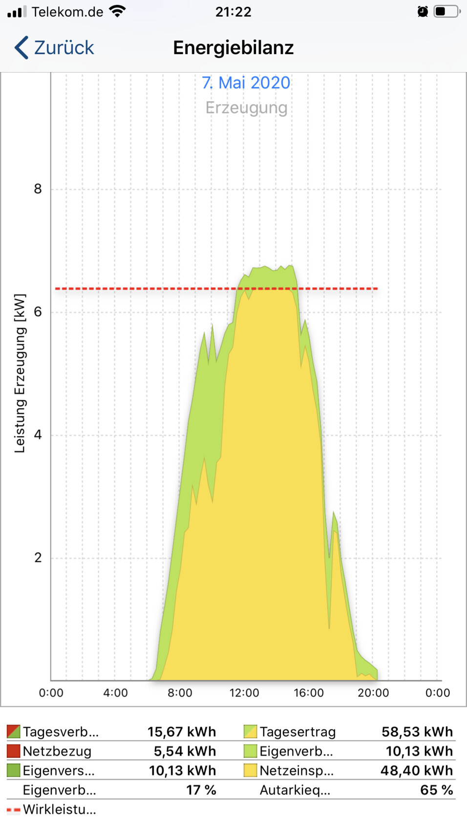

halmi
7 May 2020 21:24
Today we also had a good amount coming down from the roof, the system has 9.1 kWp.
Energy balance diagram on May 7, 2020: generation, grid consumption, self-consumption, and feed-in.
