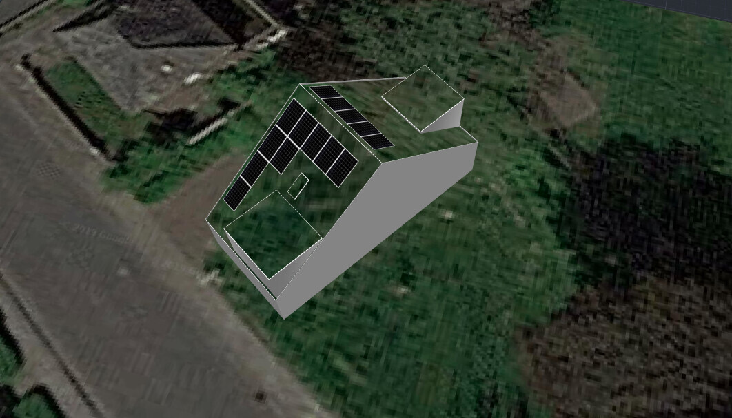

Hello everyone!
We are building a semi-detached house and want to install a photovoltaic system on the roof. The orientation would be south/west and north/east. We intend to use most of the electricity ourselves. A battery is not planned, as the cost is quite high for such a system and it probably doesn’t make financial sense.
We have received an offer that includes:
- 14x IBC MonoSol 360 (there is still space on the north/east side... does that make sense?)
- SMA SB 3.6-1AV-40 inverter
- DEHNcube YPV SCI 2MPP surge protection device
- Meter cabinet (+ accessories)
- Installation
The price is about 7,500€ gross.
The system will have a capacity of 5.04 kWp.
Currently, there are three people living in the house (2 adults, 1 child). Four are planned.
Our roof is quite simple but well oriented.
We are wondering if 5.04 kWp is sufficient?
Our electricity consumption in the apartment was always below 3,500 kWh per year, but we expect it to increase with the house. We estimate about 4,500 kWh.
Regarding the 24/7 electrical loads:
There will be an air-to-water heat pump from Novelan and a ventilation system with heat recovery.
I would really appreciate some advice.
Sufficient for what exactly?
To generate the same amount of electricity as your household consumes? - No.
Search for PVGIS online, and you can estimate the expected output of your system. Roughly speaking, if it is oriented south and unshaded, you can expect about 900–1000 kWh per kWp of installed capacity per year. Approximately.
If your expected household electricity consumption is 4500 kWh, add roughly 3000 kWh for the heat pump.
Your quote is somewhat acceptable but tends toward being expensive.
The question is, in a new build, what exactly the solar installer plans to do at the meter cabinet or what is meant by that position.
Whether placing panels facing north/east makes sense can be clarified by the professionals on site. The rules for string configurations aren’t my specialty, but with 5 panels of 360 W on the north side, you won’t get much output, and the string might even fail. But the experts there will know much better.
