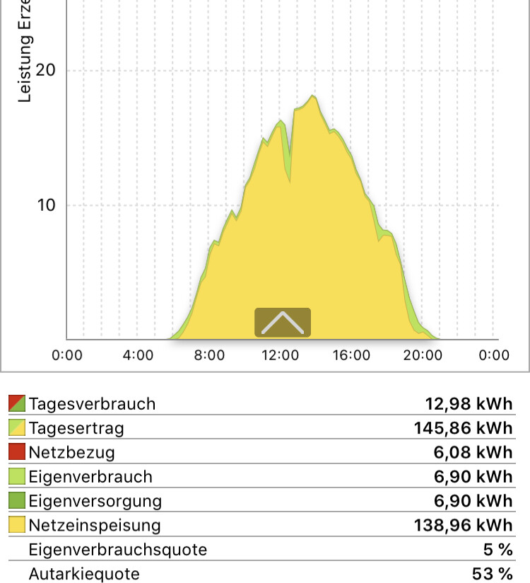

Here are the promised values from yesterday, the first day. Until sunset, we achieved 65% self-sufficiency. Then, showers were taken and hot water was prepared (air-to-water heat pump). The heating system has not yet been connected (SmartGrid). Otherwise, no hot water preparation would have taken place.
