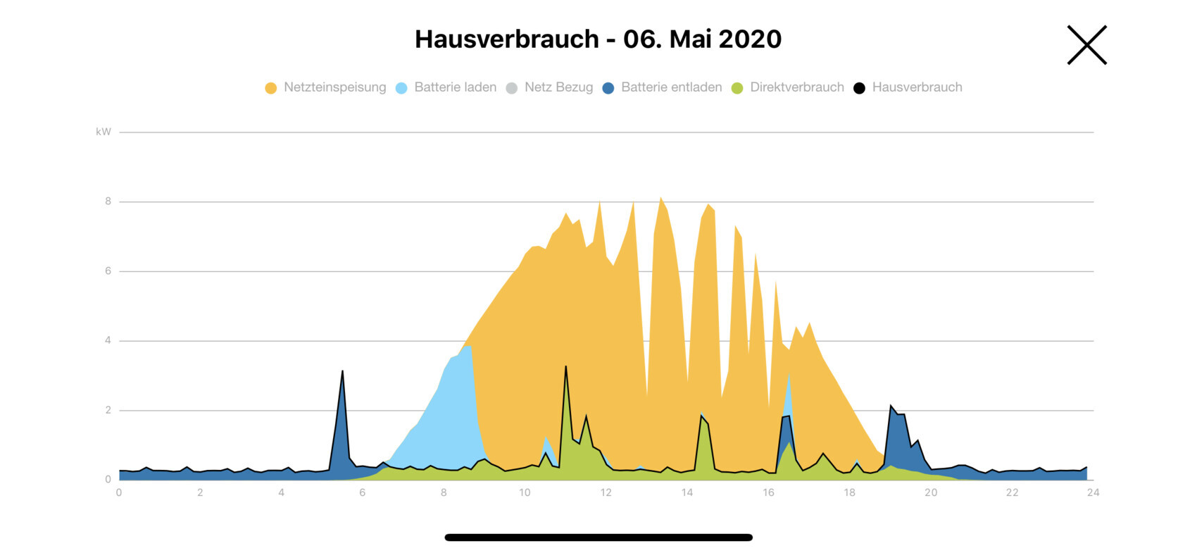

Here is a chart from yesterday without charging the electric car. Tomorrow it will include the electric car.
The blue peak between 6:45 p.m. and 8 p.m. is the dishwasher.
Hausverbrauch 06.05.2020: Farbcodes Netzbezug, Netzeinspeisung, Batterie, Direktverbrauch.

Here is a chart from yesterday without charging the electric car. [ATTACH alt="14B457B5-C000-4DA1-BF48-FBBB14CBFC14.png"]46710[/ATTACH]
A good example: you can see that around 9 a.m. the battery is fully charged. And during midday, you would hit the feed-in limit (at 50% limit due to the subsidy).
Is it the same for you, that some electricity is still drawn from the grid even though the demand can be fully covered by the battery? I had read about that.

7 May 2020 17:31
Yes, that's actually the case. But until noon today, it was 62 Wh.
In the screenshot, you can see the electric car charging (green) at 14 A via a Schuko socket, so with 3.2 kWh. Faster or more power isn’t necessary. It will be fully charged after 5 hours.

You should definitely change your charging management!
The battery should charge around midday. If you exceed the feed-in limit, you will stay below it this way. Otherwise, power is wasted. (As long as you have set the limit to “soft” and have not restricted the inverter accordingly. The SMA SHM can definitely do this as far as I know.)
Also, always make sure the car is not charged from the battery. Otherwise, you first charge the home battery and then the car battery. That results in wasted energy twice.

Specki schrieb:
You definitely need to change your charging management!
The battery should charge around midday. If you go over the feed-in limit then, you stay below it. Otherwise, you’re wasting electricity. (As long as you have the limit set “soft” and haven’t limited the inverter accordingly. The SMA SHM can definitely handle this as far as I know.)
And always make sure the car is not being charged from the battery. Otherwise, you’re first charging the home battery, then the car battery. That’s wasted energy twice over.
Please explain that in simple terms. The inverter is soft limited, whatever that means. Usually, without a curfew or Corona restrictions, the car is charged starting at 5 p.m. At that time, the battery is still full, and yes, unfortunately, I will have to charge from the battery if the photovoltaic system doesn’t produce enough. That’s just how it is and can’t be changed. After all, you don’t wait two weeks to refuel if fuel is 20 cents cheaper per liter—cool.
