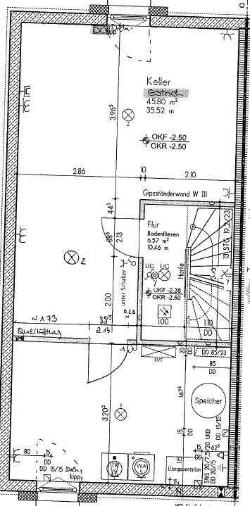

Baugreenhorn23 Sep 2020 07:53The basement of the semi-detached house is constructed as follows:
The three exterior walls are made of waterproof concrete. The interior walls are built using a stud frame construction with drywall panels installed as a single layer. I don’t know which type of screed will be used, but it hasn’t been installed yet. It is scheduled for October. Moving in will be around May 2021. We plan to tile the basement before moving in.
Grantlhaua23 Sep 2020 10:02If the interior walls are going to be drywall anyway, just fill and sand the walls, then prime everything and paint with regular but good-quality paint.
