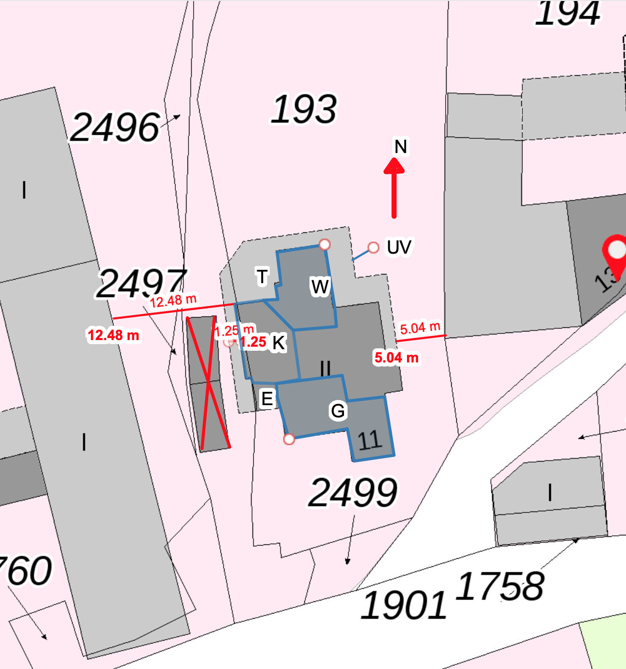

we are considering purchasing a house: North American style with a wrap-around porch on a north-northwest facing lot (large north garden).
What do you think about the attached overview? I am a bit concerned that the house might be somewhat dark inside (especially now and during winter). There are enough windows, but the porch acts as a constant shading element. On the south side, there are practically no windows, as this area faces the courtyard and garages. Also, the terrace at the corner of the house might not be ideal. However, it would still be possible to create an uncovered seating area facing the garden.
Explanation:
T = Terrace
W = Living room
K = Kitchen
E = Entrance
G = Garage
UV = Wrap-around porch
Distances to neighboring buildings are indicated.
There is a shed to the left of the house that will be removed.
I look forward to your thoughts on this..!
Lageplan eines Grundstücks mit blauem Gebäudeumriss, rote Maße und Nordpfeil.

And facing north-northwest, there is no sun in winter even without a covered porch. However, I would also follow the recommendations of ypg.

Yes, but those few minutes, or even an hour, are not really a strong reason to base your decisions solely on orientation here. If someone wants sunlight in their living space, meaning in an open-plan area, and wants to enjoy that time at home, the room must actually receive sunlight. Windows behind a porch don’t count, even if “there is some time” when sun reaches them. That would be a weak compromise. North-facing rooms can still be bright, but the sun rarely shines directly into them, typically only for about half an hour in summer.
Therefore: observe carefully and evaluate!
