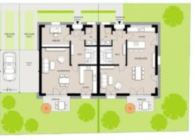

Yes, it would be from a developer and the building is still in progress. The planning has been completed by the builder, and now we have to decide whether we want to purchase it or not.
The situation with the carports is complicated. We would occupy the left half of the semi-detached house (viewed from above). To the left of this are two carports. One belongs to us, the other to the neighbor. (Yes, the neighbor has to pass by our house and our carport to reach their car). From above, our garden area does not end at our house wall but extends much further to the left, underneath the left carport. Therefore, it would be possible to see into our garden when the carports are empty.
I’m attaching a picture, which might make it easier to understand.
Who creates a design code?
Kind regards!

11ant8 Jun 2019 21:25
Famjalwa schrieb:
I’m attaching a picture, maybe it will make things clearer.
A slightly less blurry picture would be helpful, and especially one that shows more of the surrounding area to understand the location better: am I correct in assuming that the neighbor is a “rear property owner,” meaning the street doesn’t extend up to their front door and they have to cross your property? – do you even have separate plots, or does each of you only have your garden and your (in your case directly adjacent to your house) carport as your respective areas?

In cases like this, it is often the developer of a site-specific development plan.
The links https://www.hausbau-forum.de/threads/Gartenhaus-und-weg-geteiltes-flurstueck.30015/page-3 and https://www.hausbau-forum.de/threads/Reihenhaus-als-weg-oder-bessere-alternative.30615/page-2 should give you a rough idea of where my thoughts are headed.
