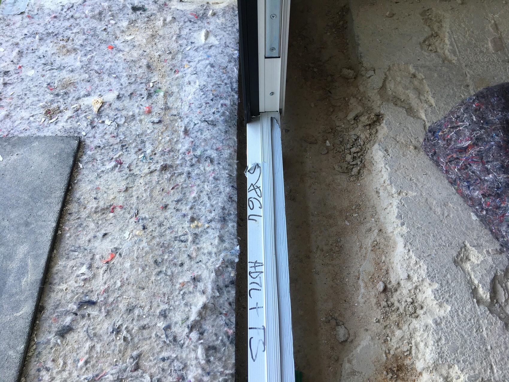

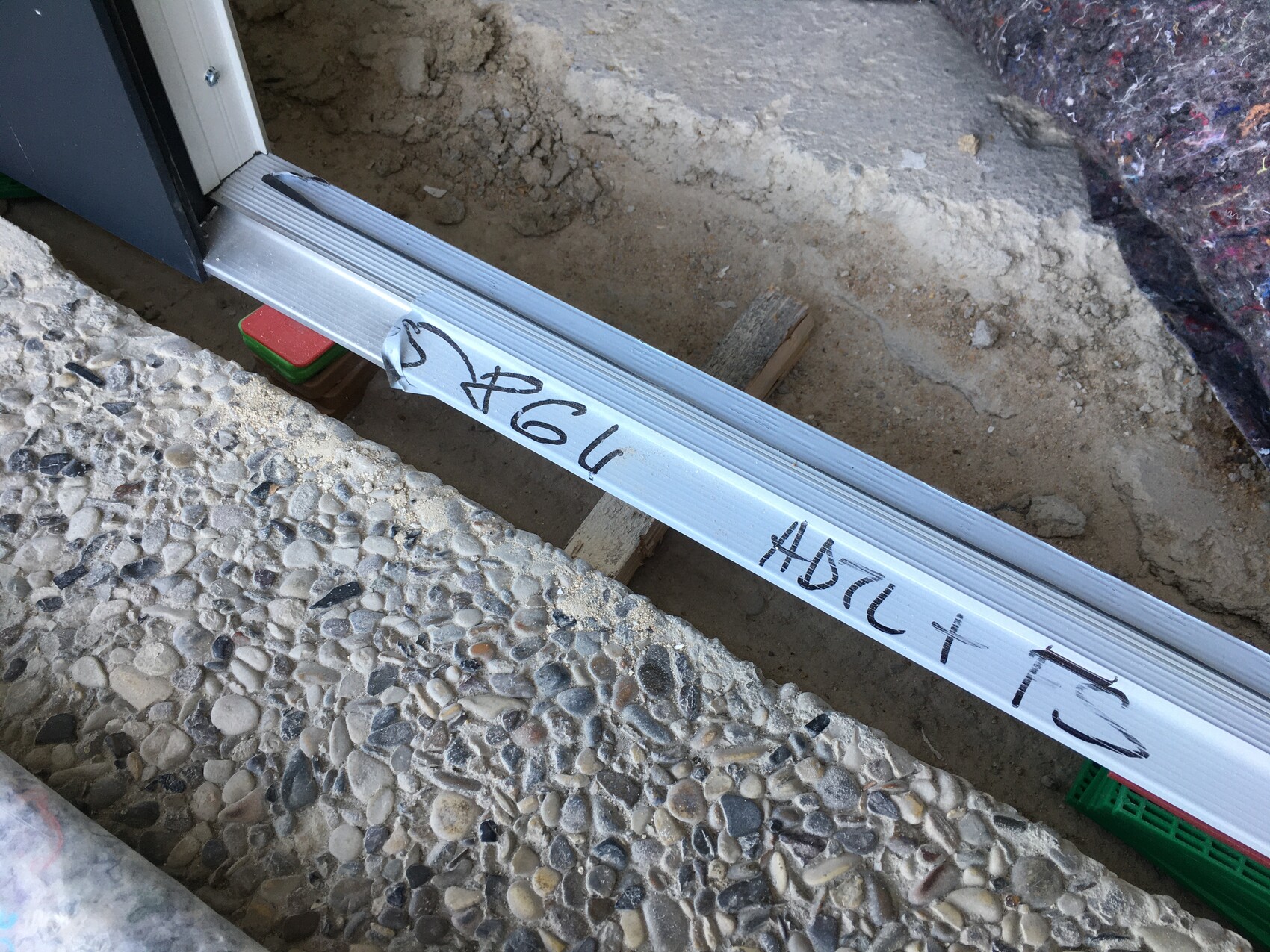

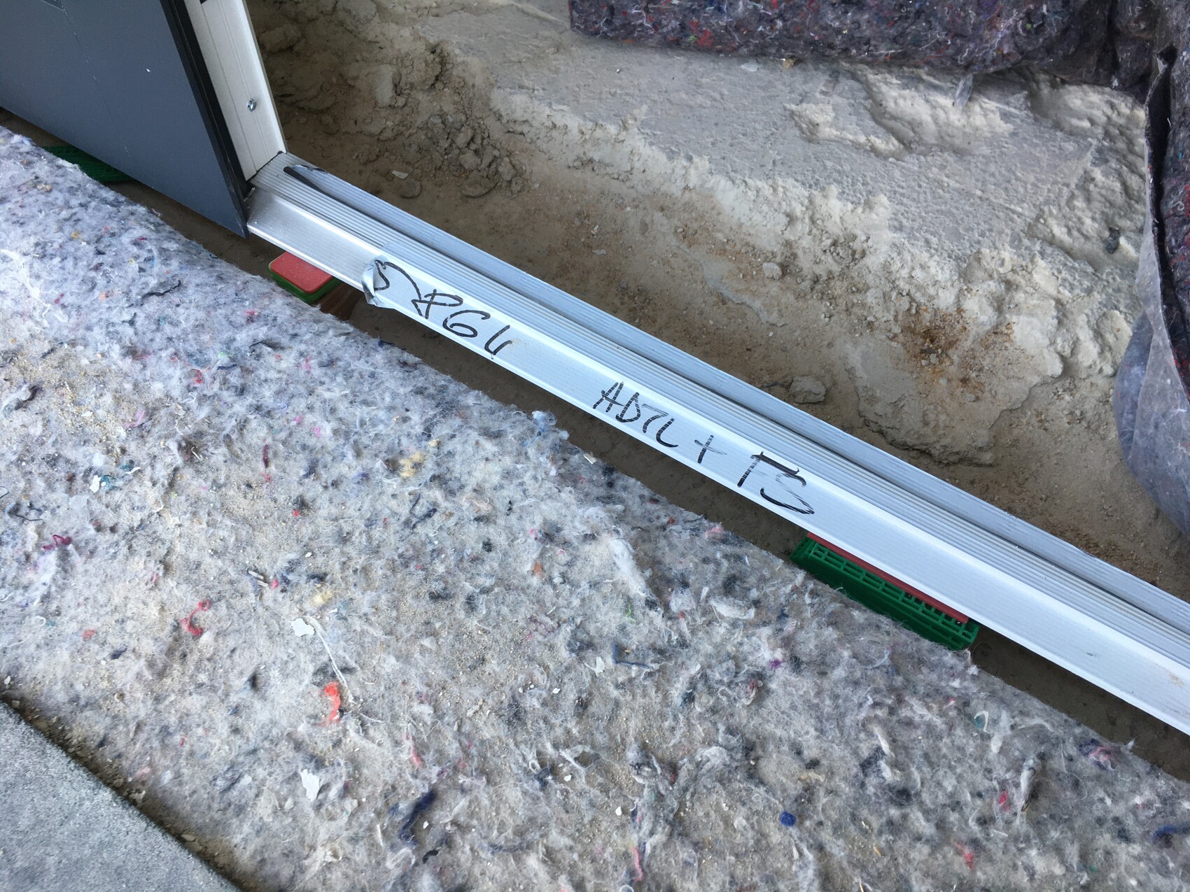

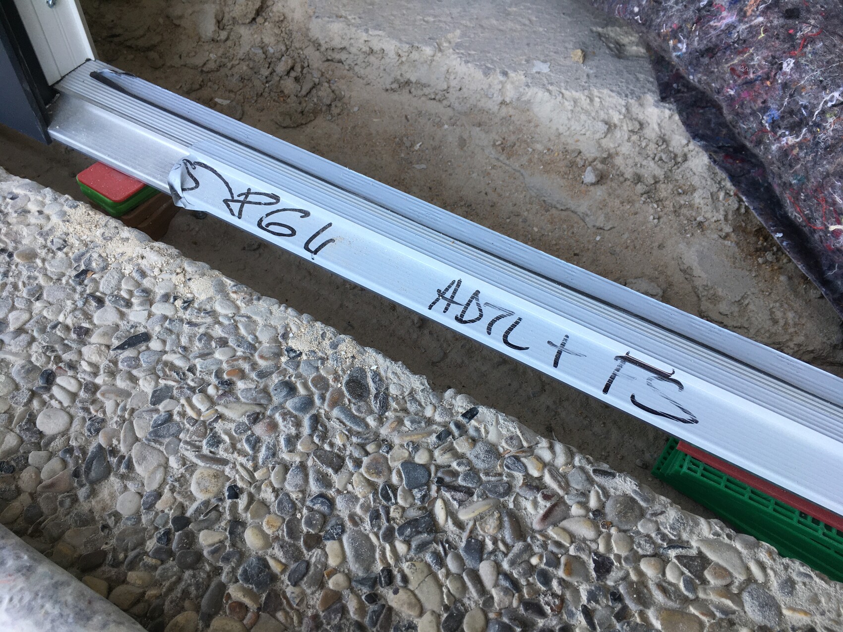

Our renovation is in full swing, and the new front door arrived last week. It already looks good.
During installation, the sides and the top frame on the inside were sealed airtight against the masonry. However, the threshold is causing me some concern. There is simply nothing under the threshold except a few spacers. The installer said that, logically, one should not step on it while the spacers are there and that concrete or screed should be poured underneath soon to make the threshold "walkable." Now I’m wondering: Is it correct that I have to take care of this, or is it the installer’s/company’s responsibility? It was sealed on the sides and top, but apparently not at the bottom.
Thanks in advance for your feedback...

dr.evil9629 Sep 2020 14:59So, by now you should have seen your new front door. How does it look there?
The tiler can of course do that as well. He advised me to have the threshold’s sealing checked and whether it might be the installation company’s responsibility. Meanwhile, I have communicated with them, and they will incorporate wood for thermal separation under the threshold (is this the usual practice?) and create a permanently elastic joint on the exterior side. I’m curious to see how it turns out...
