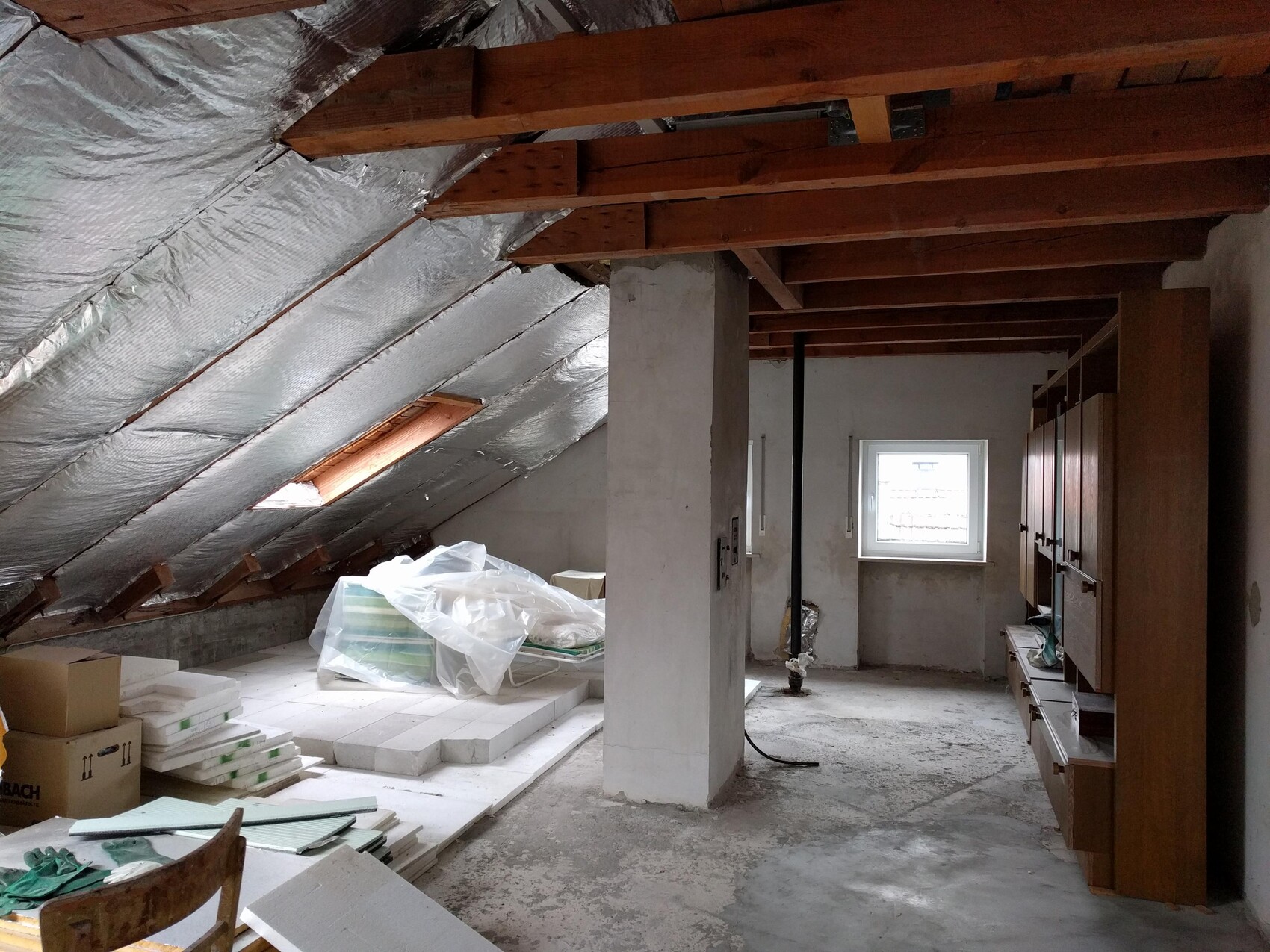

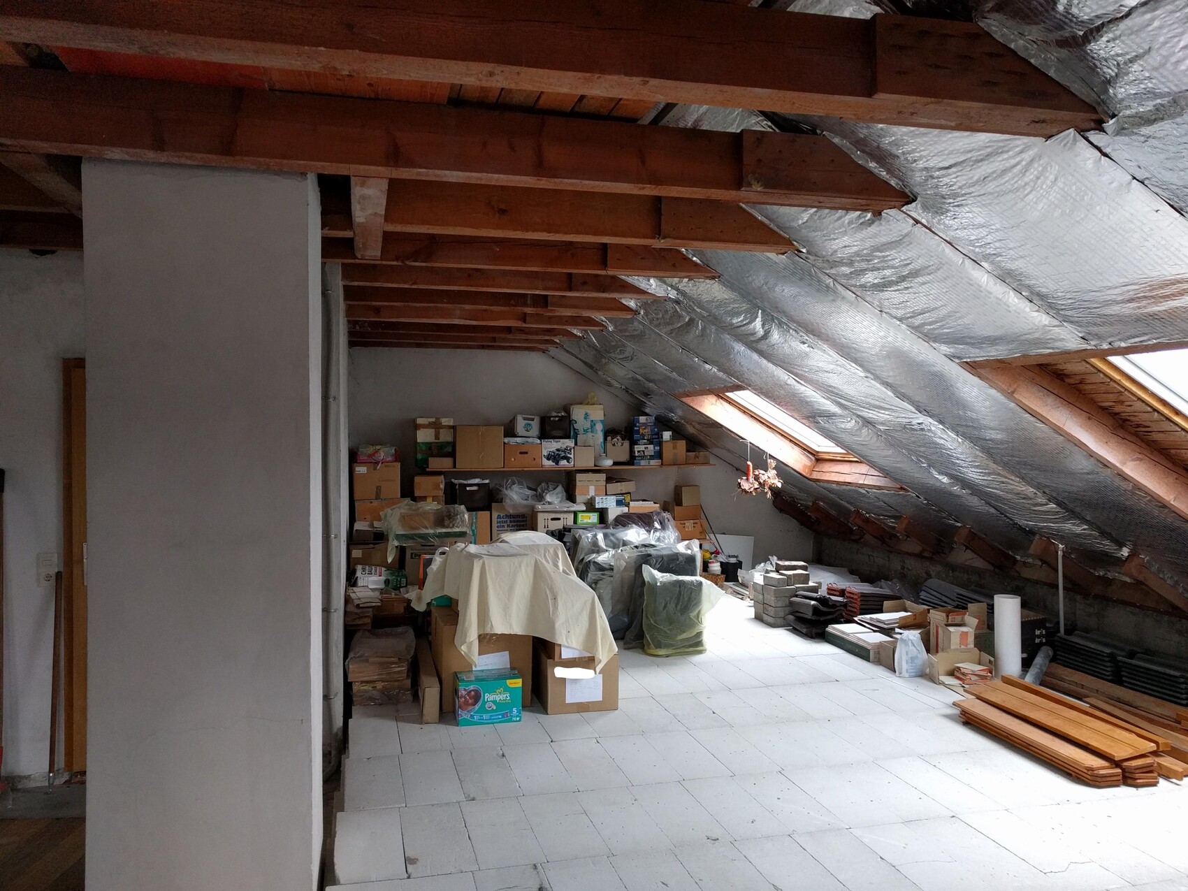

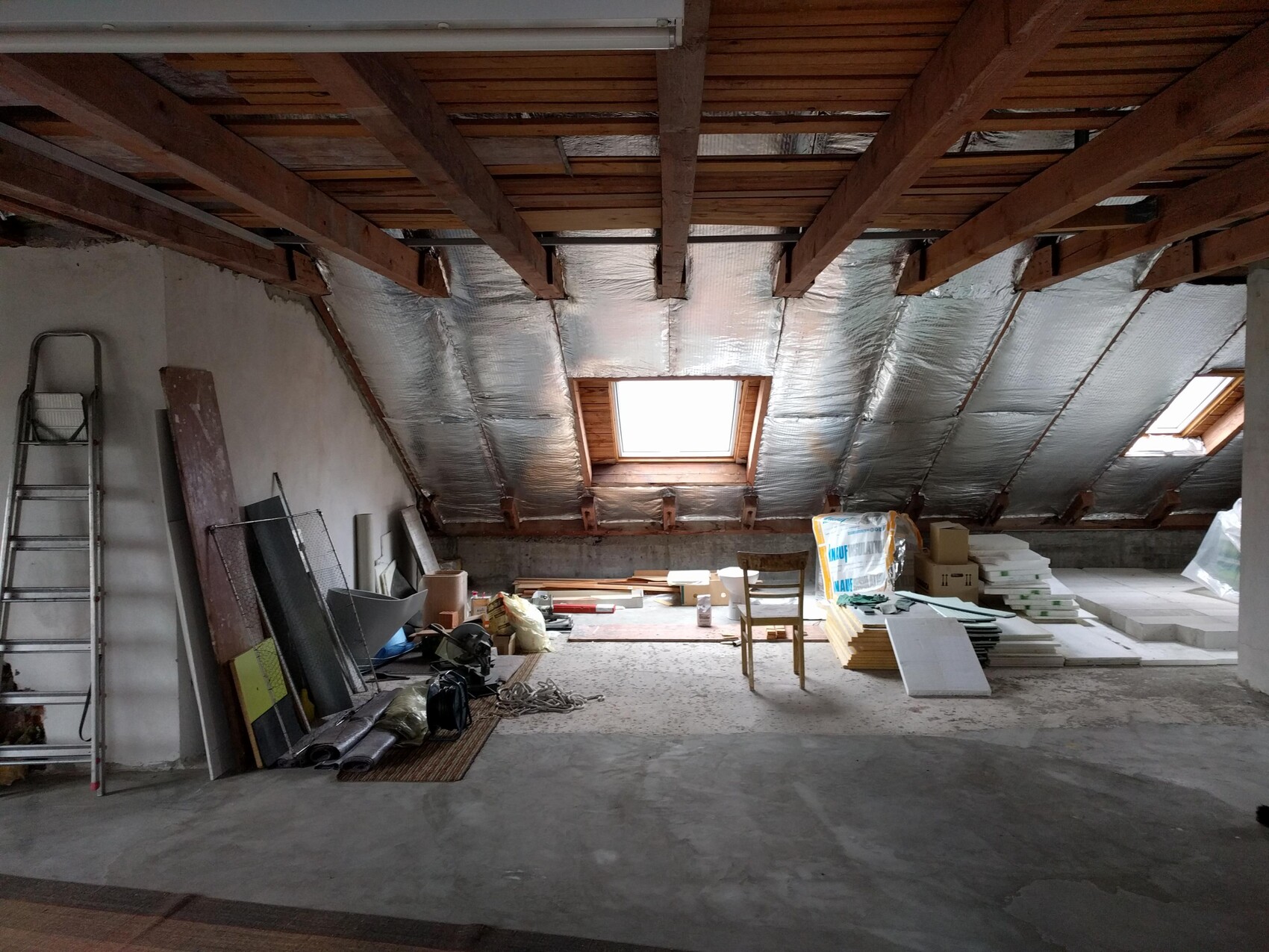

Here are some new pictures!
Attic with wooden beams, silver insulation foil, two skylights, construction lumber, and cable reels.
Attic with wooden rafters, silver insulation foil, many boxes, crates, and stacked building materials.
Attic with aluminum insulation foil on the roof, skylight, construction lumber, cable reels, and building materials.

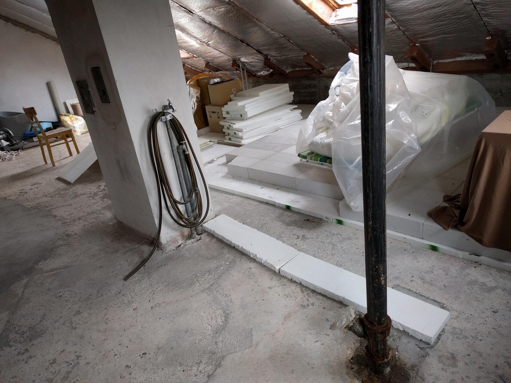

12 Dec 2018 12:42
Finally, the column in the living room. As you can see, a lintel has been installed with a wall built above it.
View from below of wooden beam ceiling with insulation foil and a white support in the room.

12 Dec 2018 12:47
kaho674 schrieb:
Sorry, where is the column in the kitchen?
There are three "columns" on this area in total.
  • Column 1 is the chimney of the central heating system plus an unused chimney, so it is a double chimney. It is located near the planned bathroom or kitchen.
  • Column 2 is the chimney right by the apartment entrance. This one is intended for a wood-burning stove and is currently used from the ground floor.
  • Column 3 is a solid column (see last attached picture). This column supports a lintel and a wall that is built up to the roof peak. The "small" section of the ridge rests on it.

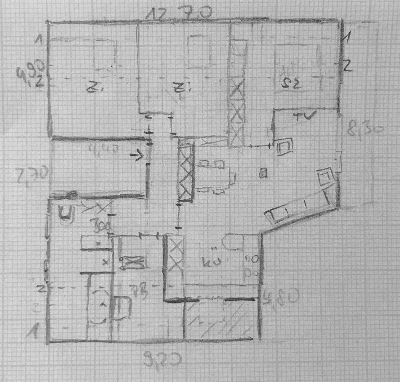

12 Dec 2018 13:23
In the meantime, I’ve sketched something out, so there’s no need for exact measurements.
Sketch of a floor plan of a house with several rooms, hallways, and doors on graph paper.
However, looking at the sloped area next to the patio door, I doubt there’s enough space for a bedroom there.
