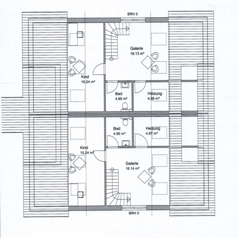

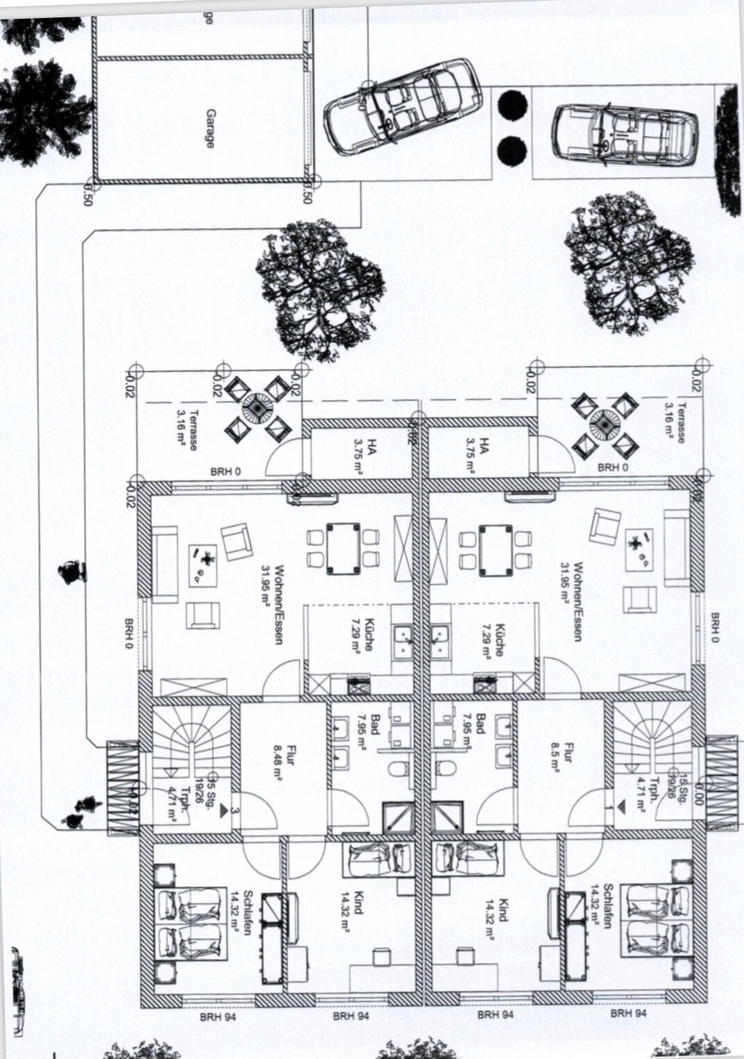

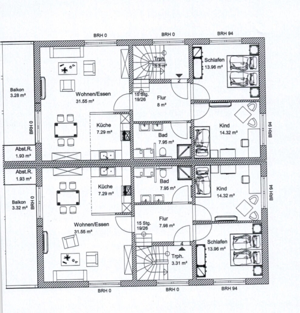

I have already shared my project here before. I want to build a single-family house with two residential buildings (a semi-detached house) and a total of four housing units in a new development area. These apartments are initially intended for rent, but might be used later for personal use or family.
The two residential units should be easy to combine without major work. For now, the ground floor forms one unit, and the upper floor plus the attic together form another unit (maisonette).
I would have preferred the bathrooms and kitchens to have windows. The architect did not include this in the first floor plan draft and says it is basically okay this way, but difficult to implement otherwise.
Since the two front doors are located on the south and north sides of the house, and the living room is on the west side (with a terrace), it is naturally not easy to design all rooms with windows.
I would like to get your opinions on the floor plan for this four-family house and maybe some suggestions so I can contribute to the discussion with the architect next week.
Thank you!
Modernes zweistöckiges Haus mit Satteldach, Terrasse und Garten; Menschen draußen.
Grundriss eines Doppelhauses mit zwei Wohnungen, Garten, Terrassen, Parkplätzen.
Grundriss eines Mehrfamilienhauses mit zwei Wohnungen: Küche, Wohnen, Bad, Flur, Schlafen, Balkon.
Dachgeschoss-Grundriss mit zwei Galerien, zwei Kinderzimmern, zwei Bädern, Heizungen und Treppen.

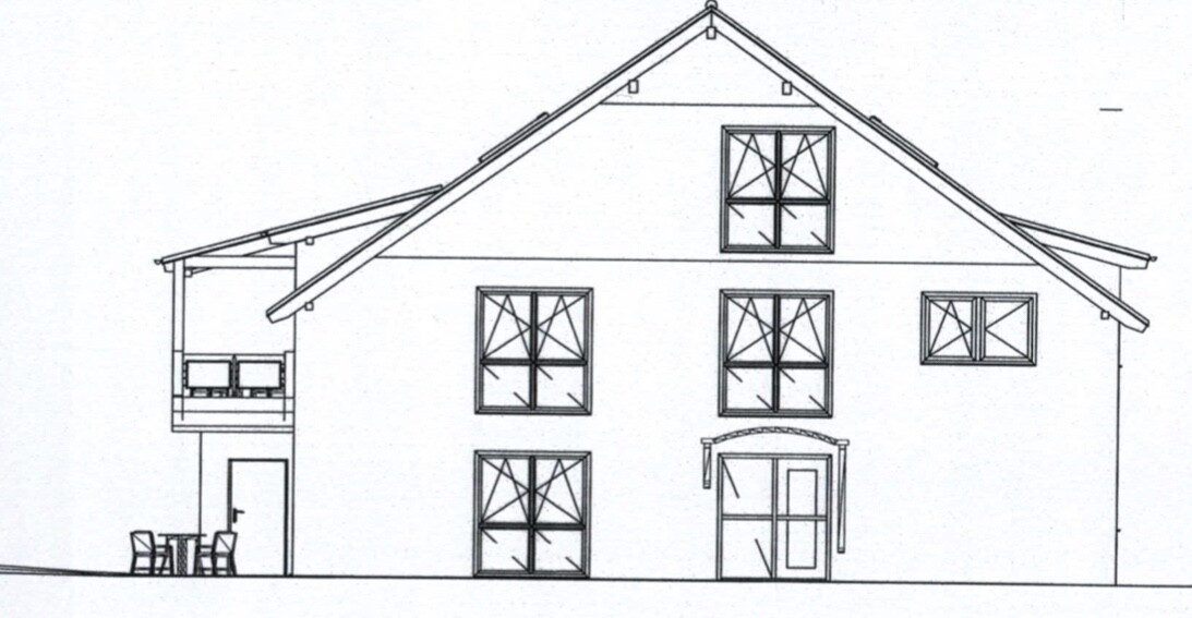

Zweistöckiges Haus mit Satteldach, Balkonanbau links, mehreren Fenstern und Eingangstür.

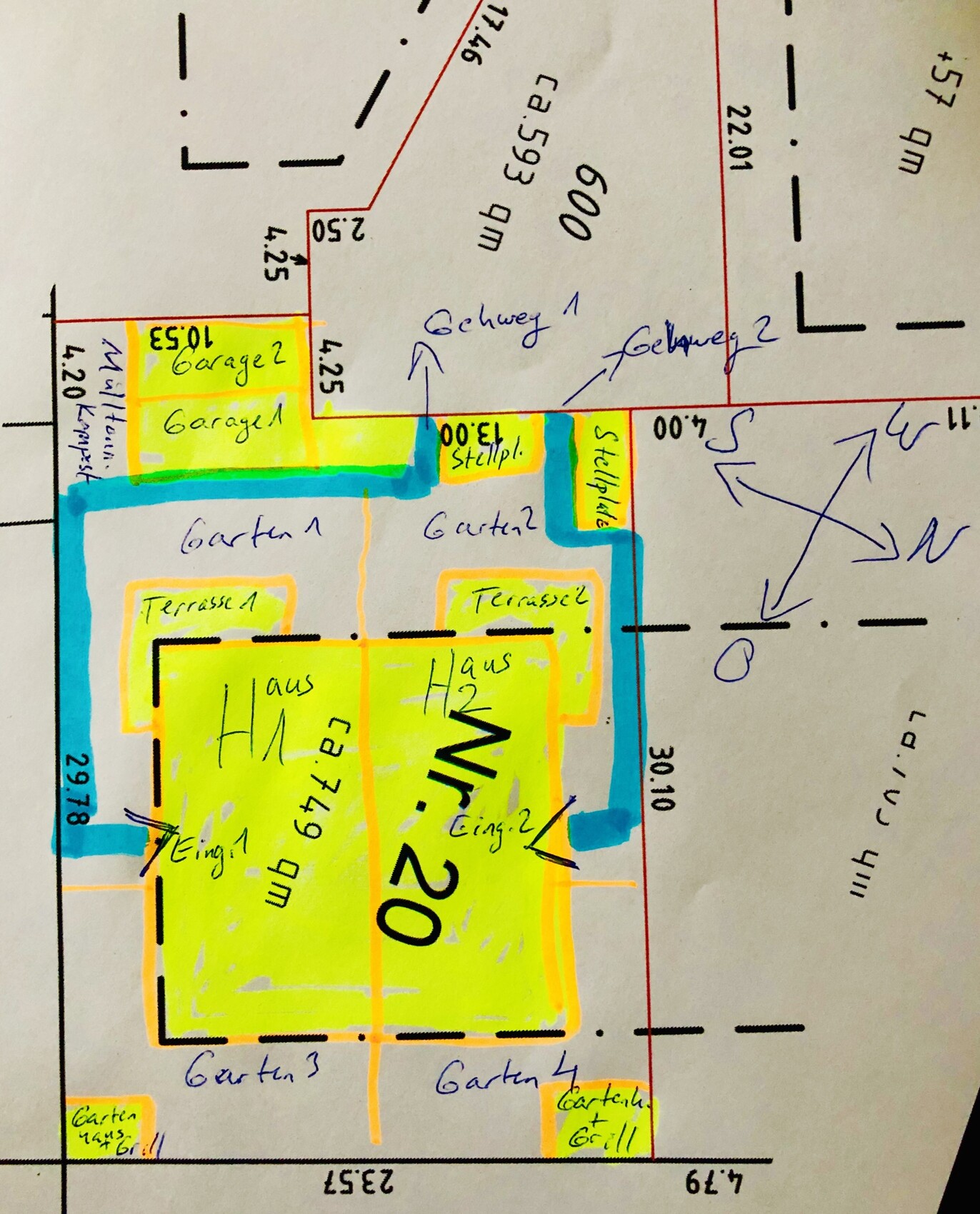

South garden? There is a four-meter (13 feet) boundary strip...
Sorry, I meant the west side, in front of the ground floor apartments.

If a family will not use the 75 m2 (800 sq ft) private, fenced garden with a garden shed, barbecue area, etc., because it’s 18 steps up and 5 m (16 ft) away, that’s not my problem..
What do your tenants on the ground floor think about tenants from the upper floor looking directly into their “private, fenced garden” and into their bedroom and children’s room? Or planting a tree in front of it, setting up their grill, placing their garden shed, or starting a compost pile there...
Honestly, think carefully again about the idea of a “private” garden for the upper-floor apartments. Your actual building footprint is almost square—so why not orient the entrances on the north side and the gardens on the south? Then you only need one path to access the two entrances, and the ground-floor apartments could have the entire garden. There would hardly be any common garden area left for you to maintain. (I’m assuming this is why the idea of 75 m2 (800 sq ft) gardens for the upper floor apartments came about.)
But yes, as a working person, I would also prefer a west-southwest facing terrace rather than one facing south-southeast.

What do your tenants on the ground floor say about the tenants upstairs looking directly into their bedrooms and children’s rooms from their "private, fenced garden"? Or planting a tree there, setting up their grill, placing their garden shed, starting a compost pile...
Honestly, seriously reconsider the idea of a "private" garden for the upper-floor apartments. Your effective building footprint is almost square, so why not orient the entrances on the north and place the gardens to the south? Then you only need one path to the two entrances, and you can assign the entire garden to the ground-floor apartments. That would leave hardly any common garden area that you would have to maintain. (I assume this is why the idea of 75m² (800 ft²) gardens for the upper-floor apartments came up.) But yes, as a working person, I’d also prefer a WSW-facing terrace rather than SSO.
I have thought about this as well. I will install/build the garden shed where I consider ideal, which would be the outermost corners on the east side. The grill spots will also be located there, which I will build as well. For compost, garbage bins, etc., there is space further away from the house behind the garages; it will not be permitted elsewhere. And hardly anyone in their right mind would plant a tree right in front of a bedroom window. All of this can be contractually agreed upon.
We also considered the entrance doors on the north side, but I see more disadvantages, such as having side-by-side doors reducing privacy, and the longer walking distances to the house are not very attractive. Besides, the gardens assigned to the upper-floor apartments would disappear completely. Do you really think I would get higher rent if I offered the smaller ground-floor apartments 150m² (1,615 ft²) of garden instead of up to 75m² (800 ft²)? The answer is clearly no. It would rather be disadvantageous because the garden maintenance expected from a small apartment would be disproportionately large, and the upper apartments would not become more appealing without garden use.

Instead of building four thoughtless apartments, where tenants usually stay only one or two years before moving on to something bigger (never mind high-quality fittings that would just raise the rent a bit), or where they could better express themselves, I would advocate a different layout with just three units.
Absolutely. Golden faucets won’t make up for washing machines placed next to them; above-average rent requires style and class. High earners don’t rent apartments with sloppy floor plans — except maybe on some prestigious avenue.

For this hope to come true, the attractiveness must be right. I was willing to search one year longer to have daylight and natural ventilation in the bathroom. Besides that: the foundation of choosing tenants yourself is to keep the ideal tenant profile in mind during planning — and that profile must be specific (meaning well-differentiated and clearly formulated)!
dobbelhaus schrieb:
I won’t build the perfect rental building, at least not with my budget, but it will be much better than many rental apartments!
Especially if your calculations only work once the building is fully rented, the apartments must suit the ideal tenants; otherwise, it won’t work.

Here is a rough sketch of what will go where, not exact to the millimeter.
Site plan of a property with House 2, terraces, gardens, garages, and parking spaces.
