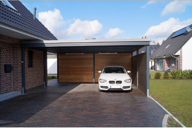

I have seen various constructions on the internet. I’ve attached pictures – this is roughly what we have in mind.
Construction:
Frame the storage room and cover with OSB panels, then staple roofing felt on the outside. Screw battens onto a substructure. For the door, use a side entrance door in anthracite.
Construction:
