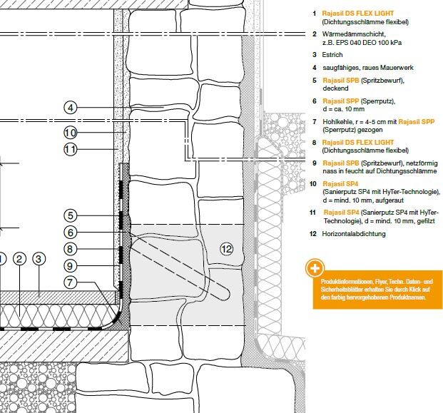

If possible, I would recommend a combination of options 1 and 2: excavate and waterproof the exterior, and install a horizontal damp-proof course at the base on the interior (whether to drive it in, saw it in, or inject it is mostly a matter of preference).
Create a cove joint between the floor slab and the wall, and coat the floor slab with a waterproof slurry up to the horizontal damp-proof course. Otherwise, you may end up with dry walls but damp feet.
I wouldn’t worry too much about structural stability—otherwise, many older buildings would have already collapsed.
For example, with Rajasil, you can download a brochure with detailed drawings from their website.
It would look something like this (c) wall-systems
