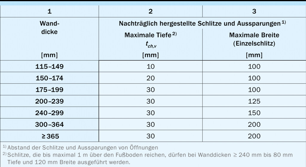

I looked up the rules regarding sand-lime bricks for you:
The effects of vertical (perpendicular) slots in load-bearing and non-load-bearing walls differ. For load-bearing sand-lime brick walls, vertical slots (regardless of slot depth) are generally not critical. In this case, the wall can be considered as two wall sections separated by the slot.
At the location of the slot, a free edge is assumed... they may also be made in non-load-bearing walls.
In other words: a channel 8cm (3 inches) wide and 6cm (2.4 inches) deep can be calculated as if you had continuously removed 8cm (3 inches) width from your load-bearing wall... without a more detailed review, however, only depths up to 2cm (0.8 inches) or widths up to 10cm (4 inches) would be unproblematic.
- For non-load-bearing walls supported on all four sides, the vertical slot can be regarded as a free edge. It must be checked whether the allowable wall lengths of the two resulting (supported on three sides) wall sections are complied with.
- When determining the allowable wall length of the non-load-bearing wall, the next smaller wall thickness can be used.

The exterior wall must be load-bearing, so shouldn’t vertical slots (regardless of slot depth) generally be uncritical?
In your table, the max. depth shows the small number 2
Slots that go up to max 1m (3.3 feet) above the floor (which would be the case here, possibly up to max 1.20m (3.9 feet); it could also be kept to max 1m since the TV is large enough to cover everything
For a sand-lime brick wall thicker than 240mm (9.4 inches), slots up to 80mm (3.1 inches) deep and 120mm (4.7 inches) wide are allowed.
Where do these figures come from? In the table, for 240-299mm (9.4-11.8 inches) it states 30mm (1.2 inches) depth and 150mm (5.9 inches) width.

The effects of vertical (upright) slots in load-bearing and non-load-bearing walls are different. For load-bearing sand-lime brick walls, vertical slots (regardless of slot depth) are generally not critical. In this case, the wall can be considered as two wall sections separated by the slot.
