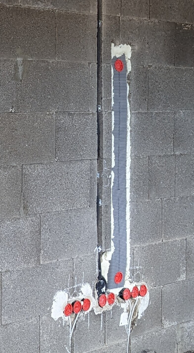

xMisterDx12 Feb 2023 22:51You don’t need a specialist for this. Just buy a standard enclosed cable duct, drill two holes in the lid and the wall, and install it.
However, for your cables, you definitely need a sufficient width and depth, or rather height, of the duct.
Whether you can just cut an 8cm (3 inches) wide and 4cm (1.5 inches) deep channel in a 15cm (6 inches) load-bearing exterior wall... no idea. Especially since the wall will be further weakened in that area by the holes for the TV mount.
At 11cm (4.3 inches), it’s no longer a load-bearing wall.
According to DIN standards, a slot in the wall should not exceed a certain size. Please research yourself to find the exact maximum dimensions.
We simply used a flat duct from the kitchen department (6cm deep, 10cm wide) and chiseled out the load-bearing interior wall made of sand-lime brick (24cm (9.5 inches) thick) enough so that the duct could be plastered in. So far, the wall is still standing and even supports the TV. 🙂 It was quite a hassle to chisel it out afterwards; it would have been better to do it while building the wall.
Alternatively, you could install a narrow drywall partition in front of the wall—using a 50mm (2-inch) metal stud, simply covered with drywall. Although this reduces the room space by 6-7cm (about 2.5 inches), it is safer from a structural point of view.
Vertical slots and recesses –
For wall thicknesses of 11.5cm (4.5 inches) and 17.5cm (7 inches) – maximum width 10cm (4 inches) – from 11.5cm (4.5 inches) openings – generally only 1cm (0.4 inch) deep.
For 24cm (9.5 inches) wall thickness – maximum width 15cm (6 inches) – from 11.5cm (4.5 inches) openings – generally only up to 3cm (1.2 inches) deep.
According to excerpt from DIN 1053 part 1.
