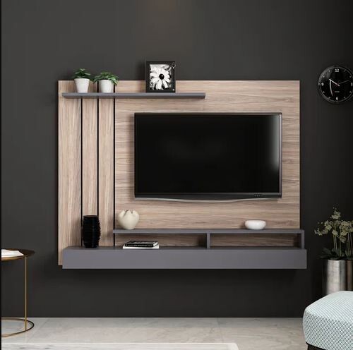

I can understand that you don't want a TV wall like that and prefer the TV to be wall-mounted, even with a highboard. That’s exactly what I have, and I’m very happy with my solution.

Gooosee15913 Feb 2023 13:23@Tassimat Thanks, we want to mount the TV as flat to the wall as possible if possible.
We have a 75-inch TV.
Walls like these usually look fine with smaller TVs, but with such a large one, the wall would need to be quite big as well.
@Tassimat What solution did you use? Also an in-wall cable duct?
