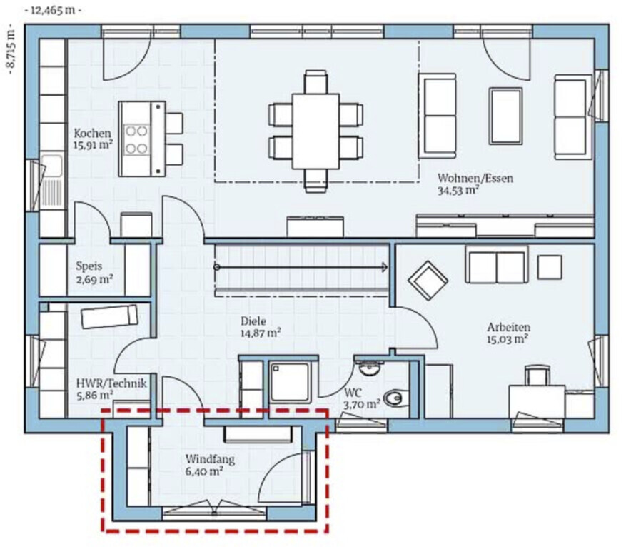

kejo84
16 Feb 2020 16:59
Thanks for the responses. Now I have a better understanding of why this is often done that way (more cost-effective, simpler, and many people don’t mind walking through the “mudroom” area).
I would probably prefer something more along these lines:
Floor plan: kitchen, dining/living area, office, hallway, entrance area, guest WC, pantry, utility/technical room
This layout offers
- privacy
- natural daylight
- no need to pass through the entrance/mudroom area
- location of the guest WC on the external wall
Bookstar
16 Feb 2020 17:02
If the land allows, it’s a great solution. But often it’s not possible.
opalau16 Feb 2020 17:03
Yes, we also did not want the toilet near the entrance area and solved it in a similar way.
face2616 Feb 2020 17:08
But that is exactly how 90% of all floor plans are designed, only you are adding a windcatcher bay window for 10,000–20,000 EUR that others either save on or that the building permit / planning permission does not allow.
However, it is certainly a good solution.
