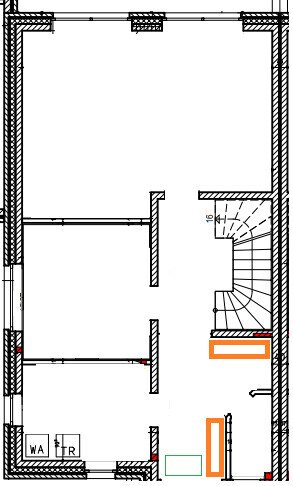

Nobody walks through dirt in our house.
The green area is a dirt-trapping mat, and the orange one is a bench where you take off your shoes. To reach the wardrobe—marked in a different shade of orange—you already walk without outdoor shoes.
So, as a guest, you can get to the bathroom from any room without dirty socks.
In our house, the bathroom is located downstairs near the entrance but not directly next to the door. The bathroom and living room doors are positioned at an angle next to each other, so you don’t have to pass through any “dirty” area. The toilet itself is situated against an exterior wall, not the wall shared with the living room. Behind that wall, there are only the TV and cabinets, while the sofa is placed along a different wall.
