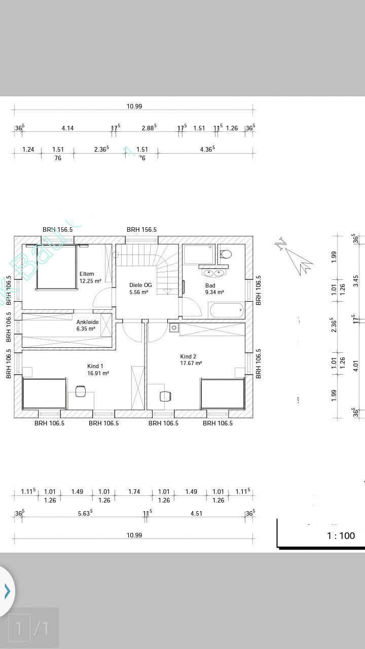

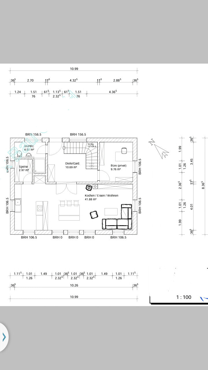

Alright, here’s a more professional approach than before. My question: can I fit a half-turn staircase in here?
Am I overlooking anything… awkward corners?
Floor plan: Open kitchen/dining/living area, hallway, office, pantry, WC.
Upper floor plan: master bedroom, child 1, child 2, dressing room, upper hallway, bathroom, stairwell, dimensions.

The dressing room and K1 are useless... forget about the dressing room... you sacrifice the child's bedroom and end up with a dressing room that has a 60cm (24 inches) corridor... (at least in my opinion).
EveundGerd26 Feb 2015 19:11
I would have an architect draw it up now. They have an eye for these things. Take your floor plan with you and explain what you find problematic.
