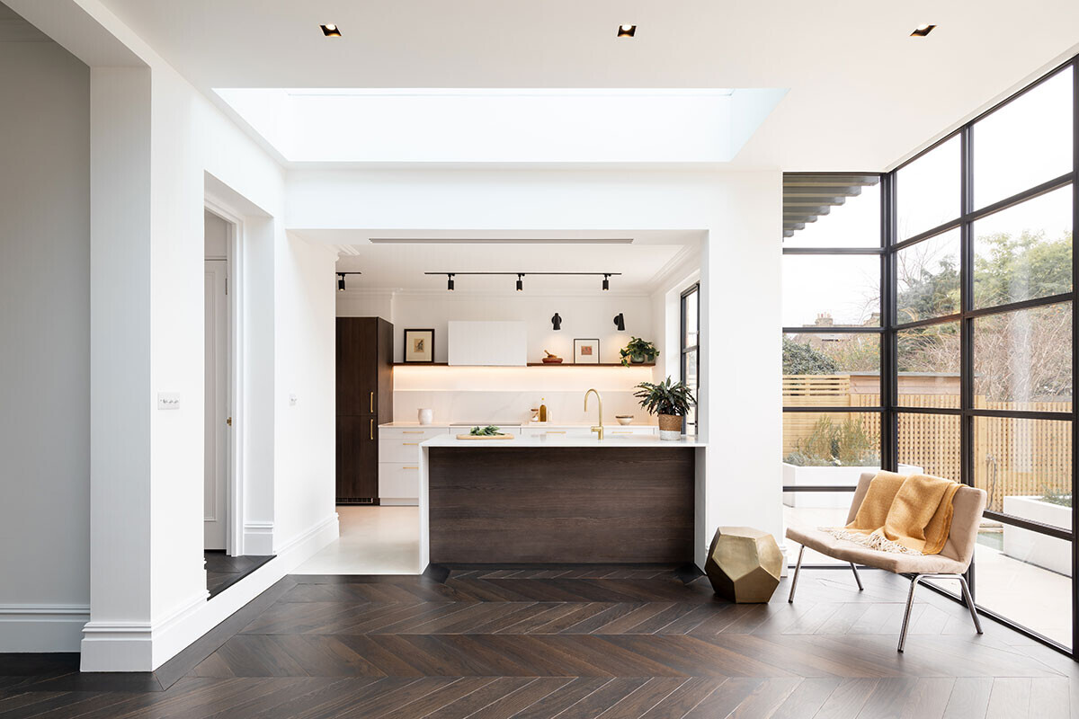

Aphrodithe30 Jul 2020 17:00evelinoz schrieb:
It was redesigned just 2 years ago, a property worth €2.8 million, and the lady definitely does not want a door to get in the way. As soon as the weather is good, this door is left open.
This property has been featured in several magazines, including architectural magazines.
Shading
Now I’m a bit confused! The kitchen in your project is exactly as I suggested! The only difference is that I proposed a row of tall cabinets along the back wall and then a large cooking/cleaning island! What I meant is that a closed kitchen like in #14 is no longer an option! What we see here is a modern open kitchen!
[/QUOTE]
pagoni202030 Jul 2020 17:48Aphrodithe schrieb:
Now I’m a bit confused! The kitchen in your project is exactly as I suggested! The only difference is that I proposed a row of tall cabinets along the back wall and then a large cooking/cleaning island! What I meant is that a fully enclosed kitchen like in #14 is no longer an option! Here we see a modern open kitchen!
QUOTE] [/QUOTE]
Aphrodithe schrieb:
Here we see a modern open kitchen! ...with a trip hazard step right next to the narrow passageway of maybe 80-90cm (31-35 inches)...??
Of course, it looks expensive and probably was, but I don’t think it’s really successful; the picture with the long kitchen layout to the left, where the actual kitchen cabinets are lined up, is now gone again.
The original poster has a kitchen of only 11sq m (118 sq ft) and is trying to find more space!
@evelinoz suggested that, in my opinion, because of the outward-opening door, which shouldn’t be necessary for the OP with proper planning.
Aphrodithe schrieb:
Here we see a modern open-plan kitchen!THIS is also the kitchen of @evelinoz’s daughter
