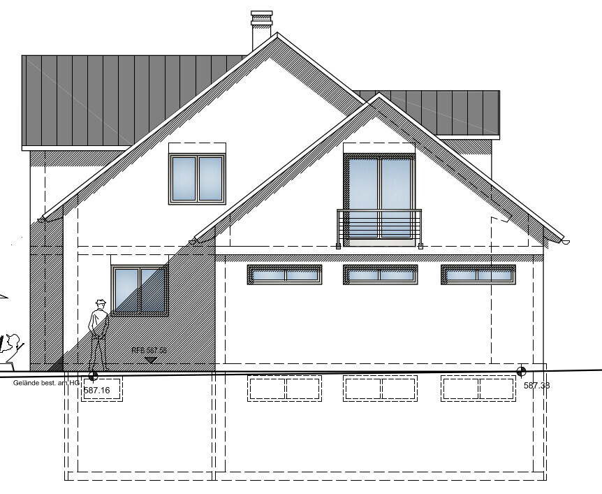

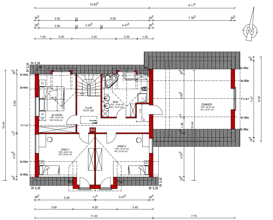

We are currently unsure if the lighting in the room above the garage (top right on the plan) will be sufficient. At the moment, only a gable window on the east side is planned, approximately the size of two doors. The room is 7 meters long (23 feet).
In principle, we are also considering dividing the room into two parts. A larger room on the gable side and a small passage room in front, for example, with a guest bed.
How do you assess the lighting situation?
What options might be possible? Roof windows / skylights?
Thanks in advance for your suggestions.

even though I still find the house somewhat "oversized" for your needs, I would definitely install skylights. This way, you can divide the space without creating a dark room, and a third child would surely appreciate having a bit of a view of the garden or driveway. I would go for it and not worry about whether the large double window is enough 🙂
Wishing you the best of luck with the build! I like the house otherwise 🙂
