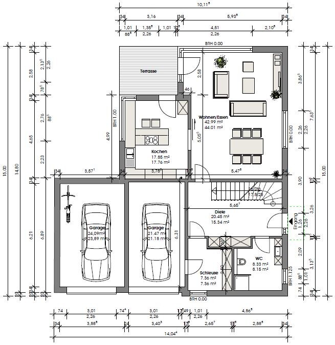

@ypg

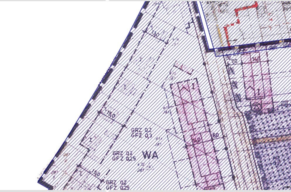

It was a bit careless of me not to indicate where north is.
In the development plan, north is at the top. The street is located where the arrow is shown on the plan. Accordingly, the house will be positioned so that the terrace faces east.

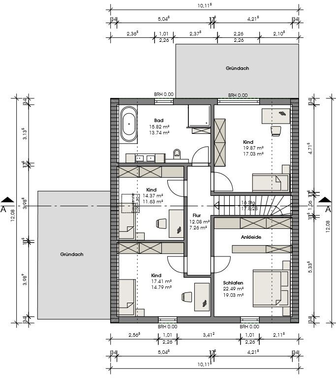

The bathrooms have not yet been planned; this is just a sample drawing.

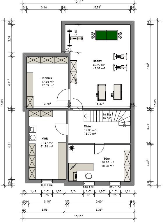

A laundry chute will be difficult because the utility room is not located beneath the bathroom.
@kaho674
I already explained the cardinal direction.
Regarding the garage, we have also objected to the partition wall. So that will be changed.
The shower in the toilet was our request to have an alternative (sometimes necessary with 5 people). The airlock area was also intentional to avoid carrying groceries, crates of drinks, or dirty shoes through the whole house.
I would also prefer the layout for the upper floor as suggested.
The sliding door in front of the kitchen should be larger, and I will take your suggestions for the hallway into account.
@Tego12
Is that really so unrealistic? We don’t have an offer yet.
@apokolok
Now you’re making me a bit worried. How much does something like this usually cost?
Well, I don’t see a second bathroom, storage space, and two garages as wasted space.
Does everyone here have just one car and manage with only one bathroom?
@11ant

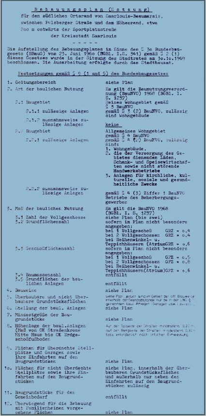

A snippet of the text from the development plan is attached. There are no specific regulations in the plan itself, but since it’s a built-up area, the building authority apparently insists on the construction method, according to the architect’s statement. I’m not familiar with this and have to trust them.
There is a reason why many people skip the basement and later add a simple carport instead.
Or why they forgo a kitchen island because it takes up space—and that space needs to be paid for as well.
In almost every room, you have 2-3 square meters (21-32 square feet) more than average. That’s great—I like that too—but in total, it also means a higher price at the bottom right of the budget.
An 8 square meter (86 square feet) shower toilet, even if it is intended as a secondary bathroom, is almost decadent.
Where I see a problem is with the thermal envelope. The garages are integrated into the house and included in the outer shell. I’m no expert, so I can’t explain it in detail, but I imagine this makes the house much more expensive.
The house with a basement alone is already not feasible with 300,000, and the technical expenses will be added on top.
Regarding the laundry chute:
I wouldn’t do laundry without a laundry chute! I would go on strike and move out! Sorry!
With 5 people, how often do you think laundry is done? Certainly every day...
A laundry chute can also open into the hallway, but I think the rooms should have been planned differently for that. After all, life should be made as easy as possible. You don’t want to bring barriers into the house!
In that sense, I would have rearranged the rooms: the 10-year-old, for example, could already get their room on the ground floor, since they will soon be leaving the nest.
Move the utility room upstairs. Take the garages out of the insulated envelope, place the entrance on the north side, and have a common room facing southwest with a nice west-facing terrace.
But the design seems to be fixed already?
I just realized you are female. Unfortunately, Tapatalk doesn’t show that. Do you do the laundry?
Many people plan their utility room upstairs.
What also plays a role in the cost is the basement, which here apparently is being finished as a livable basement, meaning it will be heated as well.

So, the design is not final yet. There is still plenty of room for changes back and forth. They are currently estimating costs based on this plan (there is no contract yet, and naturally, they don’t want to continue planning without payment).
The bathroom on the ground floor is somewhat oversized; we have already discussed this.
To be clear: the 300,000 is our rough estimate for the house WITHOUT the land!
I would like to have a laundry chute. Maybe we should reconsider the room layout and have some fun swapping rooms and moving walls around.
Removing the garage from the house wouldn’t fit the plot (18 meters wide (59 feet)) unless we give up the second garage.
