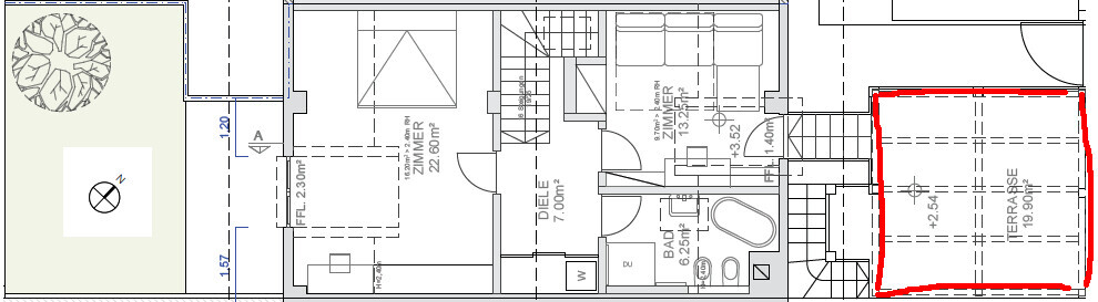

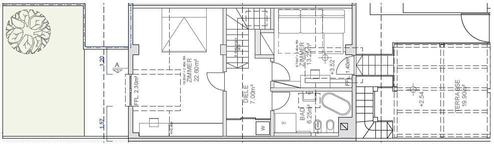

Here is the current ground floor plan:
One thing is certain: the bathroom will be removed from the center, and we both agree on the following solution:
This means the bedroom will be converted to the entrance level, creating space for a guest toilet and a storage room.
Our dilemma is: kitchen or living area – which should face the dark north and which should face the sunny south? Many people advise deciding based on how the rooms are used: where we spend most of our time, how much we cook, and how much we relax on the sofa. That room should have more natural light.
However, I only partly agree with this, since in winter it’s dark for almost half the day in the mornings and evenings – so it actually doesn’t matter as much where there is more light. Also, during summer the blinds or shutters are usually closed to keep the heat out. In spring and autumn, our terrace offers pleasant dining opportunities 🙂
That’s why I wanted to ask for your opinions on how you would arrange and use the rooms.
Here are the options:
1. Kitchen in the north – living area in the south
2. Kitchen in the south – living area in the north
(P.S. The window on the north side can be adjusted arbitrarily)

- Regarding the traffic flow from the entrance area, the kitchen would rather be located to the northeast. Is there an outdoor area/terrace? If so, where?
- The layout would then be more northeast versus southwest. The southwest room really gets a lot of light.

It is clear that information is missing here. Basically, it is always about the structural framework and soil stacks (soil and waste pipes). For that, all floors need to be seen first. Then I assume this is not an original drawing. If the original is available, it might be possible to identify where the load-bearing walls are located. Where is the staircase currently situated as shown in your proposal? Probably, there will be a load-bearing wall between the kitchen and bathroom. And what is that in the middle? Is that the heating system?
Even with number 3, the layout of the house is not clear to me. Are these staggered levels towards the street? If there is no basement, the technical installations must be located somewhere.
Do you mean the east terrace?

The terrace is located on the north side,
hm... The terrace faces north, okay, more like northeast:

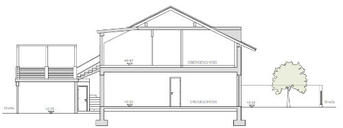

ypg schrieb:Sorry, since I have all the plans in my mind, it all seemed logical to me. Here is a side view of the house, so the terrace faces north, the garden (with tree) is to the south. In this image, you can see the two paths leading to the terrace and the door to the small boiler room, which is about 1m (3 feet) lower.
And even with #3, I don’t quite understand the house layout. Are there staggered levels towards the street? And if there is no basement, where does the technical equipment go?
ypg schrieb:Definitely on the north side. On the south side, there is approximately 5m (16 feet) between the house and the street.

ypg schrieb:I deliberately didn’t mention this because according to the structural engineer, removing the load-bearing wall is not a problem; you just have to install steel beams. As you can see in the first picture, the staircase is not yet built; it will be constructed later.
It’s clear that some information is missing here. Generally, it’s always about structural integrity and waste pipe stacks.
ypg schrieb:Yes, that’s a pellet stove, which will be removed. The heating room is under the staircase that leads up to the terrace:
