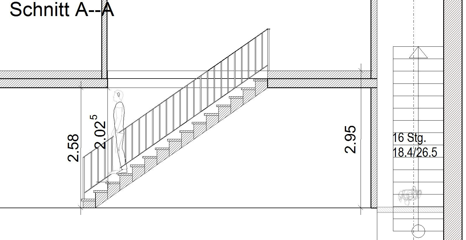

Well, the layout and the staircase don’t quite convince me yet. The section in the other direction is missing. Especially when going down, you need at least 20cm (8 inches) of clear headroom above your own height for comfortable walking:
Section A--A: Staircase with railing, figure on steps, dimensions indicated.

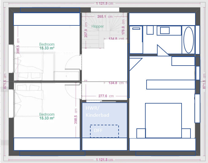

I quickly made a sketch. With a knee wall. No need for continuous skylights here.
Floor plan of an apartment: two bedrooms on the left, hallway, utility room/children's bathroom, open living area on the right
It also works without a walk-in closet, allowing for a more spacious bathroom and bedroom.
Could the floor area be reduced by adding a roof terrace or balcony? Unfortunately, I’m not familiar with the regulations in Switzerland. A kind of setback floor is also conceivable.

I quickly sketched it out—with a knee wall (drempel). That way, no need for roof windows or skylights.
This also works without a walk-in closet, allowing for a more spacious bathroom and bedroom.
Could the floor area be reduced by adding a roof terrace or balcony? Unfortunately, I am not familiar with the regulations in Switzerland. A type of stepped floor (setback floor) is also possible.
Are you planning to do it yourself (DIY)?
But that would reduce each of the children’s rooms by about 3 m² (32 sq ft). Then they become too small for us. But thanks for the suggestions. A terrace could actually be doable.
hanghaus2023
20 May 2023 18:47
With a roof terrace, there are solutions that do not interrupt the eaves. However, 14m2 (150 square feet) less means one room fewer.
